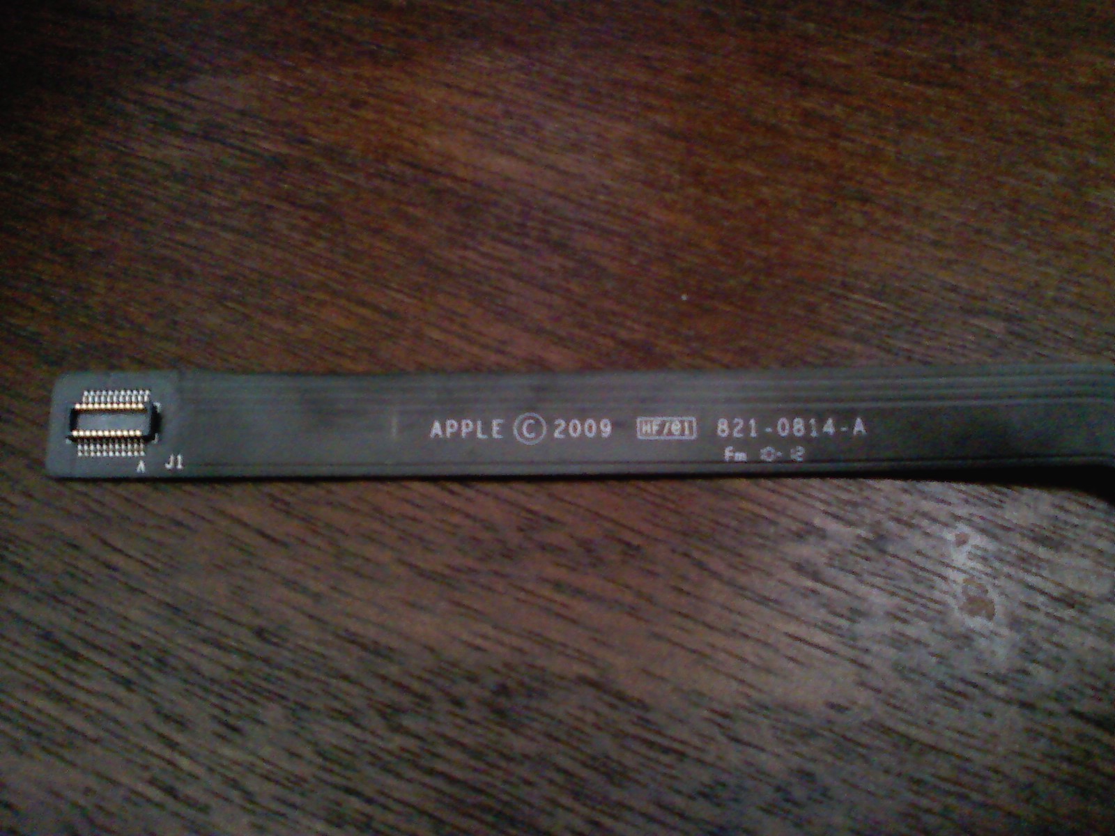

To replace a bad sata cable, search on ebay the serial number of your sata cable (see attachment).

I am sorry my post didn't help you. I had a bad sata cable which did not deliver any power to my hard drive. It was easier to diagnostic my issue.
Your issue might be the data from your sata cable. The perfect situation will be to "borrow" a sata cable from another macbook and test it. There is a guide on ifixit for removing a sata hd cable.
The only tricky part when you separate the cable from the IR sensor bracket (step 9). The connector releases the cable with a flip-action living hinge lid (like a tic tac opener).

Just wanted to update, I got a new sata cable off ebay and that did the trick! Everything is now working as it should. It recognizes the original drive and the Mac OS boots, and its even going faster now too.
On a side note, there was nothing visibly wrong with the old cable. Seems like a pretty big oversight for apple to have under-engineered this cable, especially considering how much this laptop originally cost.
