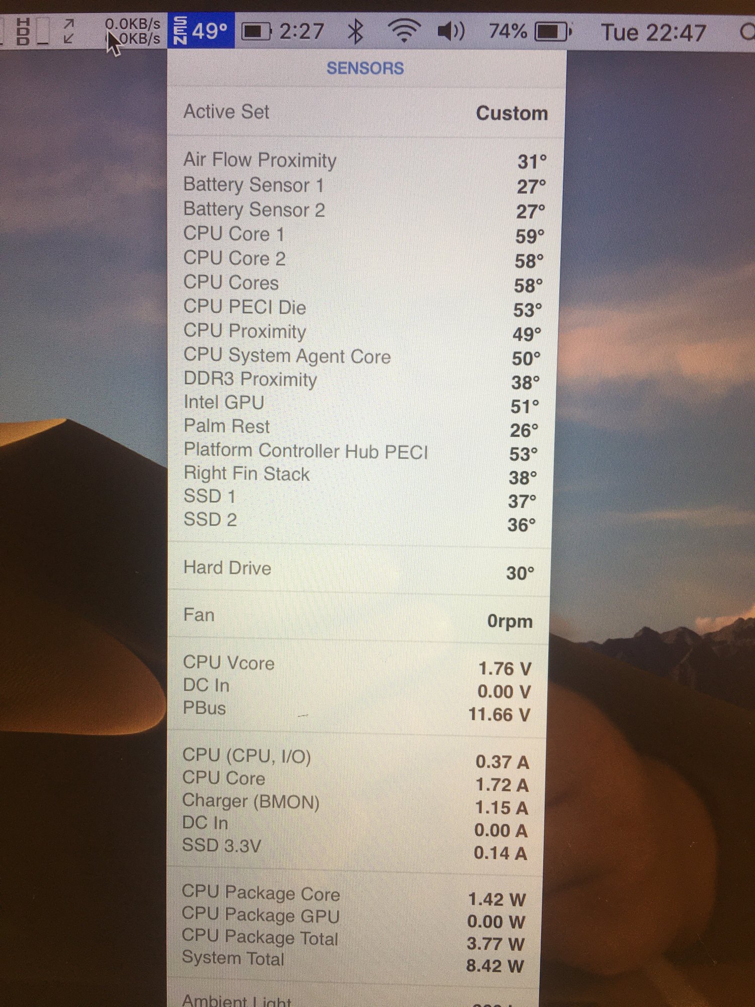

I configured iStat Menu’s 5.1 and saw that the system fan was running at 0 RPM which I thought was odd, the temperature was also around 55-60°C which I thought was normal for idle, I turned the MacBook off and removed the bottom to see if the fan was turning and upon starting the laptop the fan burst into life, however, iStat Menu was still showing 0 RPM. I am unable to manually control the fan speed with iStat, I have tired SMC Fan Control, MAC Fan Control and they are all the same. The problem arises when you try to tax the CPU as the fan is just not moving fast enough to cool the CPU effectively and the system isn’t ramping the fan speed up on a temperature increase. I am unsure as to what could be causing the issue and have combed through google trying to find a similar problem but all the fan issues seem to be with the fan running at full RPM.

Just a quick update on this issue, I have tried the following courses of action to try and resolve this problem so far:
  • SMC Reset - Using the following method (Shift + Control + Option + Power Key got 10 Seconds while plugged into the charger) The charge indicator flicked from Green to Amber then back to Green.
  • Fan replacement - A new fan was fitted as I thought that the fan itself may not be returning the RPM of its motor.
  • Apple Hardware Test - Returned following error codes ‘PPF003’ and ‘NDC001’
I know that the fan is still running upon boot and while using the MacBook, the system runs ok and the CPU isn’t throttling back as if under fault conditions. If I could get the fan to work correctly I would have a fully usable system at the moment I am worried that it will keep overheating when running intensive apps or multitasking.
Has anybody else ever seen this issue? I imagine it’s a problem that has been caused by the liquid damage, however, it’s odd how I can’t even manually drive the fan via one of the numerous fan control apps for Mac OS.
Any input will be greatly appreciated 🙂

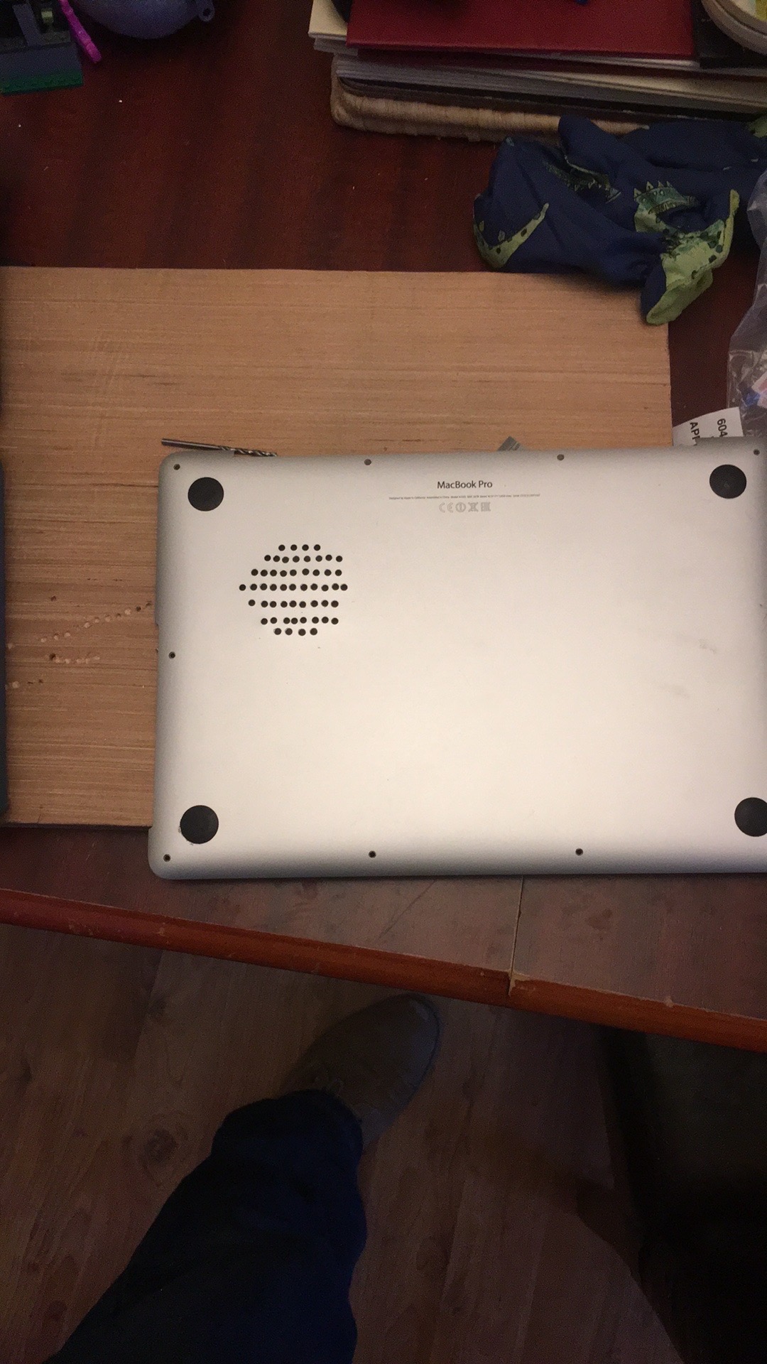

So here is the final plan of action for the MacBook Pro, if this doesn’t work it will have to be returned as I will have exhausted all my options for a ‘work around’ and I will be satisfied returning the MacBook Pro for a refund knowing I have done everything I could to make it work. I have purchased a cheap replacement bottom plate from eBay for £12 for the MacBook Pro so that I don’t damage the original one. This one looks in fairly good shape and is cheap enough to be thrown out if this goes horribly wrong. I intend to modify the case around the fan, I will drill some extra ventilation holes where the fans intake point is (Central) the photo attached shows the plan of action. I am not sure what size holes to drill as of yet was thinking around 3-4mm diameter per hole. I have also purchased some fine stainless steel gauze which I intend to bond to the inside of the case, this will act as a dust filter and stop any foreign objects from entering into the MacBook. The gauze is extremely fine and shouldn’t add too much thickness to the base. I intend to bond it to the base with some double sided adhesive tape used in phone screen repairs so it’s incredibly fine.
