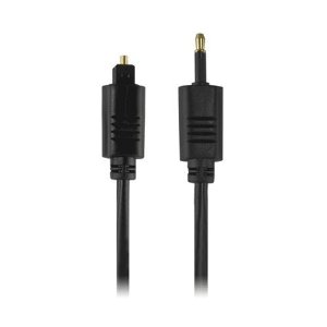

It isn't an optical cable like you know. It looks like a headphones adapter with optics on the end.
