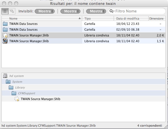

I already found a driver in hp, but i installed it and when i click on the scan app it appears a error of some kind of conflict with TWAIN Source Manager.Shlb in library with the app HP Scan

Solved!
solved same problem I had....by putting an old version of that library (from Time Machine backup) in the right folder as you see in attachment.
Ciao
