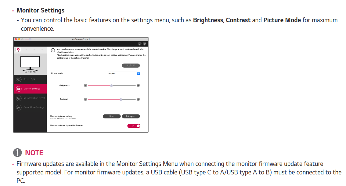

Do you have this monitor and MacBook Pro yourself?
According to LG software guide firmware updates should be available also from Mac version of their OnScreen Control software (except from some LG monitors models, but 32UN880 is not among them). They update this software quite often, latest version is from 08/29/22, worth checking as it also enables you to control modes/brightness/contrast from Mac.
I have MBP but not 32UN880, but it is strong contender in my monitors choice (I'm after 4k upgrade). Pasting links to software guide and latest OnScreen control software for you :cool:

I haven't tested the latest one but I've went thru several older version and they never allowed anything but just screen split function under MacOS, even version number kept increasing and it should have had all the features but it did not. There is another thread about that. I just posted there to check if someone tried if this has recently changed, but I fear it is just version number / date code update but the same app as before (it was like that when I tested it several times myself). I have newly installed MBP 14" myself so I'm hesitating to install this garbage again just to see it is still the same.
Anyway, I have Windows machine here I can use for that if really need but I'm not sure if that makes any difference or if there is even any firmware released this year.

So you say options from LG manual are not available? That would be strange. Anyway they want us to use usbc-usba cable for update, interesting.
I believe that only apply to Intel based Mac's and Mx based do not have all the features. I think that manual has been the same all the time. But I haven't tried the latest version yet, if the miracle happened and they added Mx CPU's to support all the features, but in the past there was no difference.
In Windows PC I used to update firmware back in Jan 2020 I used only USB-C to USB-C between the two and it worked.
