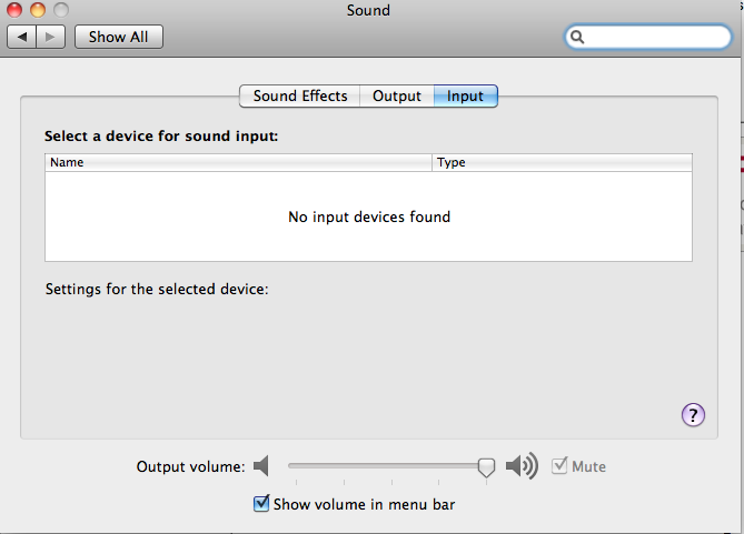

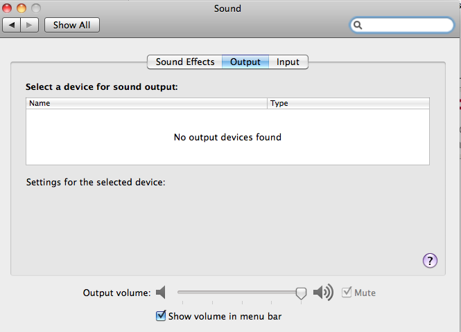

Check System Preferences > Sound > Output or OPTION/Alt click the sound/volume icon in the Menu Bar and tell us, what is listed and checked as Output Device.
This is the input and output screen shots

Silly Question ~ MUTE
Silly Question, but you DID notice that the system has been 'Muted'.. I hope.. and if NOT, then I will suggest 'hitting the Mute/F10 button' to see if anything magical happens..
Usually an Increase in Volume will disable the MUTE, but I cannot see why else it would appear as such here.. Good Luck!!
