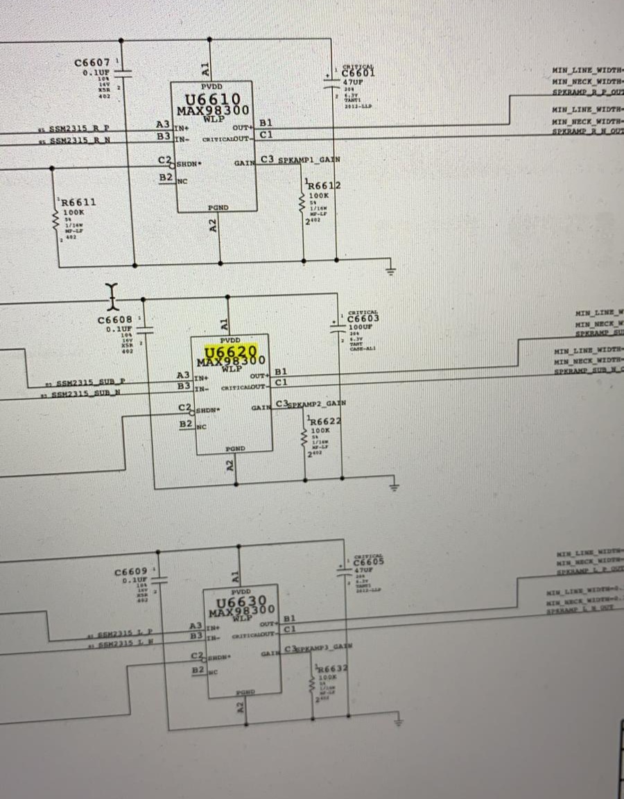

Dear all,
I ended up on this thread after seeking on Google for the same issue that I was facing on a MacBook Pro A1278 2011: tinny speakers and no subwoofer. No boot chime, no boot beep codes if no memory fitted on purpose, etc.
I tried Bootcamp, Windows sound options, etc. mentioned on this thread unsuccessfully so I sent my board to repair.

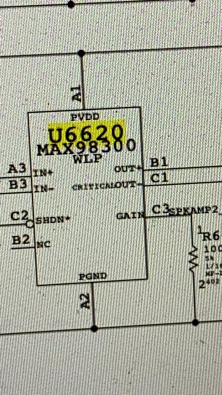

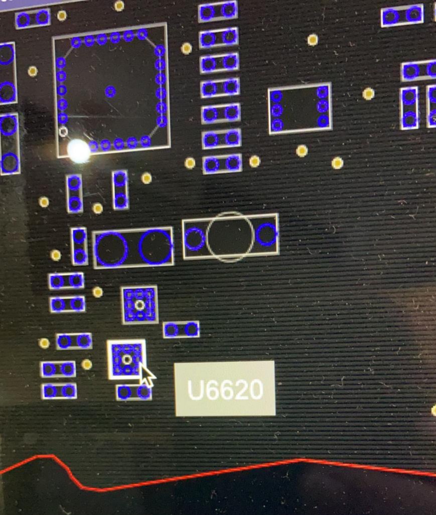

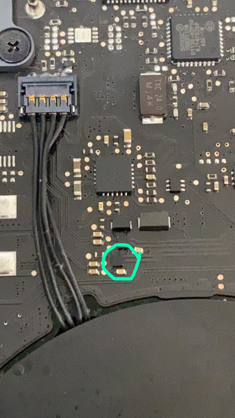

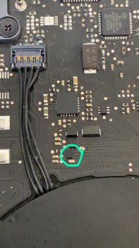

The tech pointed out to be a common issue with either component U6610, U6620 or U6630. He mentioned that they are normally glued to the pcb with some epoxy or so made glue because they tend to pop out of the pads. He even sent me some schematics and pictures that I'd like to share with you may you end up on this thread too using Google.
After resoldering U6620 on its place, the full spectrum sound is working again.
I hope that my experience may help others and save you time and efforts if you happen to have to troubleshoot this same issue.
Best regards,
Alberto.
