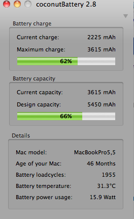

Hello folks. I have a mid 2009 macbook pro and its battery cycles are sitting at 1955 as of today. Ive been getting the "replace soon" message (on battery indicator button on top of the screen) for a few months now. I have noticed that the macbook starts to slow down a bit when i have a good few windows open.
Playback of videos has also been terrible if there are a lot of windows open. Never had that problem before. Only started up a few months ago. It very well could be the whole issue with Flash player though. Or is it the battery that causes this too? Here is a screenshot of coconut battery.
Do you guys reckon i should change the battery out now or would it be safe to continue using it for a while?
Hello folks. I have a mid 2009 macbook pro and its battery cycles are sitting at 1955 as of today. Ive been getting the replace son message (on battery indicator button on top of the screen) for a few months now. I have noticed that the macbook starts to slow down a bit when i have a good few windows open.
http://imgur.com/j6FpZsi
2000 cycles?!?! I'm suprised it still works. Try downloading coconutbattery and tell us what the stats are, Id like to see! Edit: duh they are there already, my phone didn't parse the link right 😀
I would recommend replacement.

Edit: just saw the Coconut information...Health is 66%...I would change it.

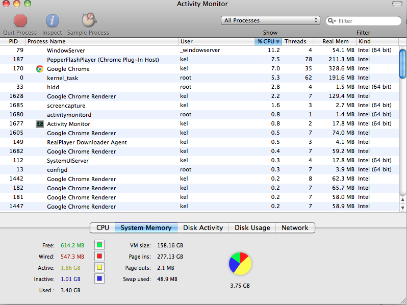

The slowdown is probably due to your Mac not having enough RAM.
Open Activity Monitor and go to the System Memory* tab and look for Page Outs and Swap used and report back.

Ya battery health is down in the 60's right now. Im going to calibrate it tonight. havent done so in a long time. Guess im just waiting for the "Replace Soon" message to turn into "Replace Now" 😀

Open Activity Monitor and select All Processes and then sort by CPU to show you the process(es) slowing down your Mac or speeding up your fan(s) or causing more heat.
I barely have more than two processes running at one time. Its always just google chrome and maybe itunes(very rarely though)
If you want to check if you have enough RAM....
Do a re-boot. After an hour, check your "page outs". If you have a bunch of page outs, it's indicating that you can use some more RAM. Adding RAM will make the computer run faster and smoother.

Whats all the page out stuff about? Im not quite sure what that is folks but from the activity monitor picture it says its 2.1mb and the laptop has been on for about 6hours now
Your lag could be coming from Chrome. Using Chrome makes my 2012 MBP lag like mad if I keep it open for too long.
Check this out...it will explain what "page outs" are. The short version is that if you have a bunch of page outs, your RAM is overloaded and you can use more RAM.
Well it does say the more free ram the better. Ive got 600mb free as shown in the above pic. Dont know if that is good enough. Had a look at the specs of my macbook and it has two 2gb ram modules. So ideally i would need to but two 4gb modules. Which including the new battery could set me back up to 150e. if thats what needs to be done so it shall be done. Not in the very near future though 😀 maybe i a few months id be able to get that!
