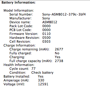

Have a look at the capacity via System Profiler > Hardware > Power.
there you will see
Full Charge Capacity - the capacity it can hold why it is fully charged
Charge Remaining - the capacity it currently has
Cycle Count - number of battery cycles (have a look at MRoogle to find thousands of threads about all this)
Condition - dito
There is also CoconutBattery which gives you the original capacity (the full capacity it had when it was build) and the age of your Mac.
And again, use MRoogle to find plenty of those battery angst threads.

I lost a hardrive on Mac Book Pro after 2 plus years. This may be the problem: The Mac book was starting up when the Sony battery failed without warning. Showing full charge, but only charged to 1550 mAh, instead of 6000 mAh plus. Causing a catastrophic failure when the hardrive is starting and needing the most power. The power supply (the battery) lost 3 of its 4 cells. The Sony batteries appear to be the problem and needs to be recalled.

Mine is made by SMP apparently so I don't think I have the problem you described. Although saying that, it feels as though it is not charging fully, how can it only last less than 2 hours! I remember when I first got it it was more than 6hours.

If the health is above 80% capacity with less than 300 cycles you have nothing to worried about.
