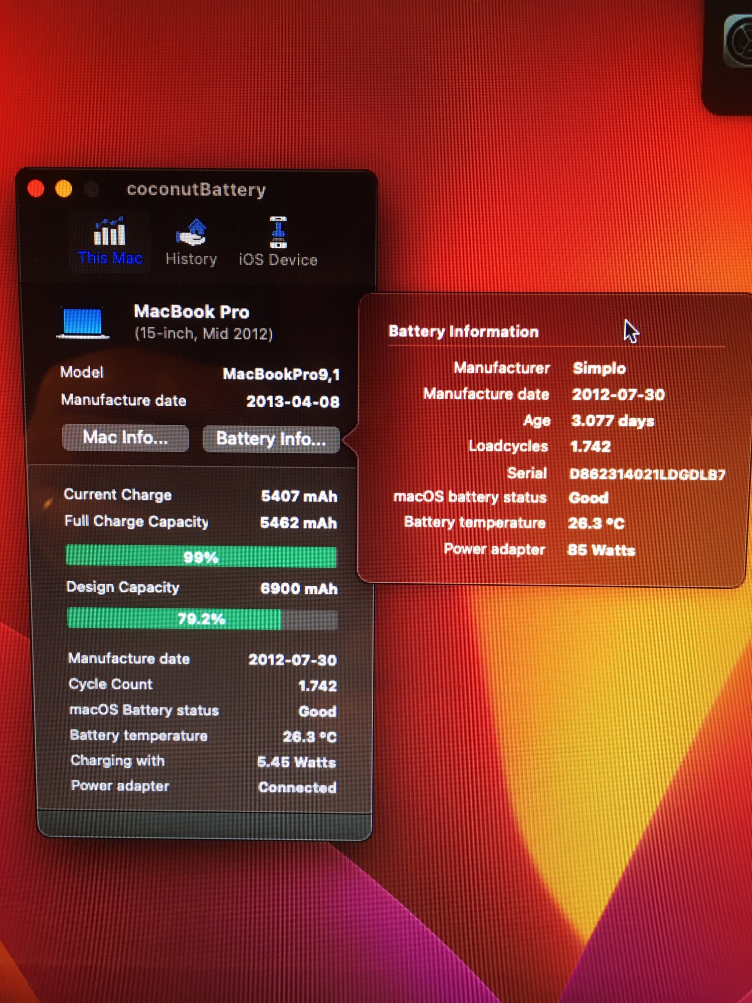

The battery of my MacBook Pro from 2012 is still performing well:
Noot, did you ever had battery swelling on 2012 Macbook pro?
Is this still the original battery?
As far as I know this is still the original battery. I bought this MacBook second hand in 2015. Never had any issues with the battery.

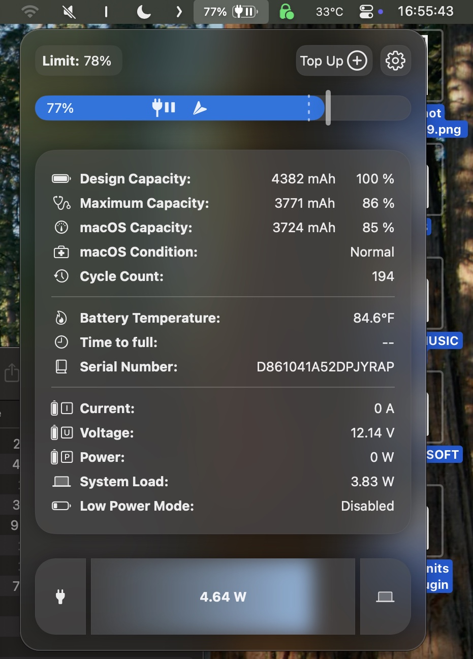

There's no reason to unplug your MBP if you install an app like Aldente. You can just set the battery percentage to an optimal range (i.e., 80% or less), then leave it plugged in. For example, I usually have AlDente set to the low 70's % (right now it's set at 73% charge).
There is also a FANTASTIC battery management app called "AlDente - Charge Limiter" and it allowed me far more control of how my MacBook charged. You can specify a specific battery level and your Mac will stay there and only fully cycle as you wish. I'm using that on an M1 and M2 Air that stay plugged in and rarely leave their spot. Really enjoy the software.

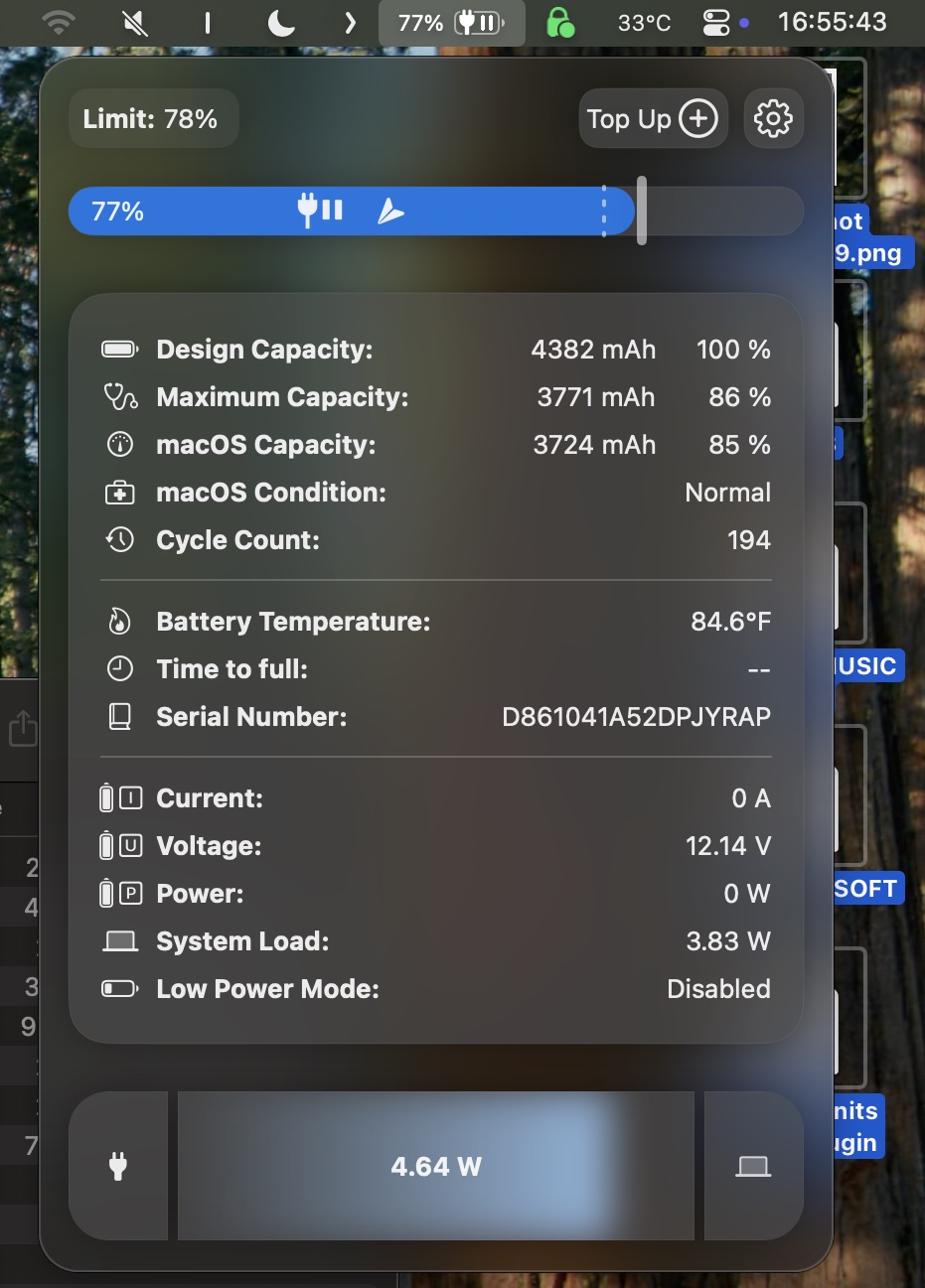

There is also a FANTASTIC battery management app called "AlDente - Charge Limiter" and it allowed me far more control of how my MacBook charged. You can specify a specific battery level and your Mac will stay there and only fully cycle as you wish. I'm using that on an M1 and M2 Air that stay plugged in and rarely leave their spot. Really enjoy the software. View attachment 2477144
I use that utility as well on my new 14” M4 Pro MBP. I concur, it’s an awesome tool! I keep my battery around 75% and top off only if I’m going mobile for the day.
