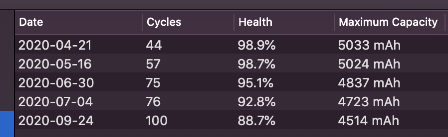

My 2018 MacBook pro is now under 90% battery health. I've had this laptop for 2 years, and it has spent most of its life time plugged in, so the cycle count is low on the laptop. If the advise is to not let it plugged in, won't that just impact battery health even more since it will increase cycle count?

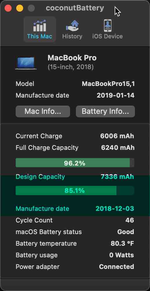

OP: I had my 2018 15" for two years but I had my battery replaced in December of 2019, and already down to 90%. So after 10 months, I have lost 10% basically.

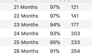

I had a 2017 MBP used daily, plugged in most of its life. 29 months and 89 charge cycles. 93% battery health. My wife has easily 2x the cycles I do and she's in the high to mid 80%.
I would be happy with that. The battery health feature Apple utilizes will charge your battery down to 80% and back up to 100% especially if you leave it plugged in a long time.

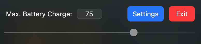

I have been utilizing Charge Limiter to keep my MBP around 60-75% and keeping my laptop plugged in. This does utilize more charge cycles but supposedly keeps the battery healthy.

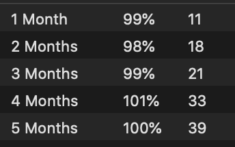

I kept my 2015 MBA 3 months (95%+), and I kept my 2017 MBP for 29 months (93%+). I plan on keeping this 2020 MBP for 3 years. Both my MBA and MBP I kept plugged in for most of their lives. Sold both back to Apple.

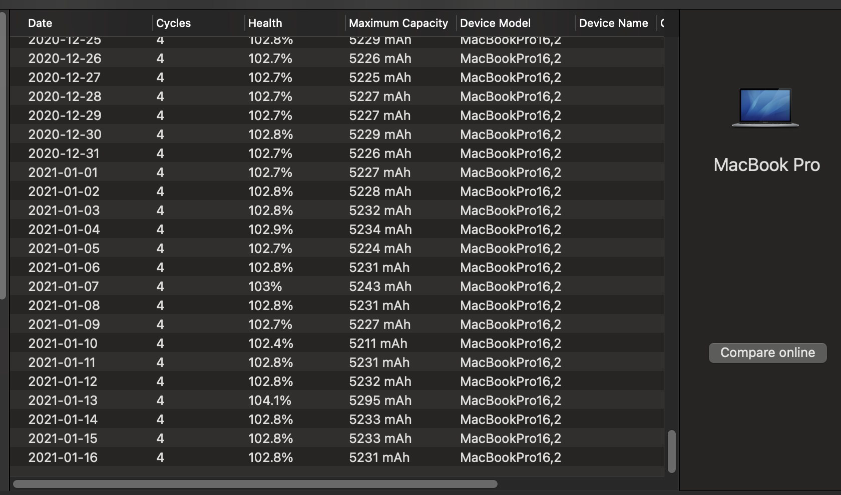

Here are my stats in case anyone wonders if I can backup my words. Only keep the mac plugged in all the time if you are using a charge limiter set to 50-60% (like I am doing). And if you go down that road you definitely need to cycle at least 20-100% ~once a week. I've gone lower than 20% many times and health is still sitting above 99%.

I'm pretty happy with my 2020 MBP. I am treating it very differently than I treated my 2017 MBP (keeping it plugged in all the time at 100%).
My 2020 MBP I have AlDente keeping it at 70-80% mostly. Unfortunately, due to my work situation, this laptop spends all its time as a desktop.

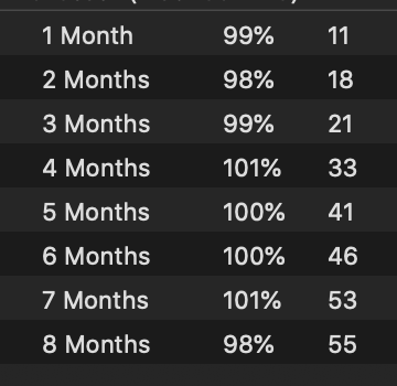

I've had my 2020 MBP 13' since 10/20/20. It runs mostly off of AC power (4 cycles) - at 70%-80%.
My wife's 2017 MBP is fairing far worse... She's at 76% capacity right now and has gotten the "replace battery" warning several times. She often uses her battery (away from wall power) so she doesn't run AlDente or anything like that.
My 2017 MBP went from 104% to 94% in 29 months.
