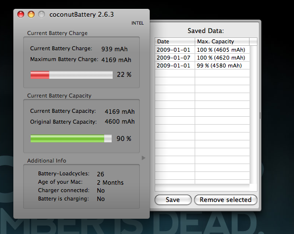

Mine is at 26% health with 203 cycles. Gonna go to the future shop tomorow and see if i can get a new one. I do have a garranty so im hoping it will cover it!
Something to watch is using bootcamp with another os while on your battery. Since you are not i os x it wont be monitoring the battery and when you reboot it will see that so much charge has just disappeared. The other day i was using windows for specific class then changed back os x afterword without recharging. After doing so my battery health was at about 60% with 25 cycles. But after recharging and fulling using the battery in os x only for a couple times the health has crept back up to the high 90%.
i came to this forum as my battery health had dropped from >90% to 74% within 24h. i unplugged it just an hour ago, when the battery was at 21% - and when i unplugged it, it instantly dropped to 4%. that's how i noticed the battery health was @ 74% (iStatPro). however, after plugging it back in, leaving it for half an hour (being used tho), and i then unplugged it, the battery health kicked back to 92% and the battery charged actually increased (just by unplugging) from 20% to 34%...
so it seems to me to be some kind of problem with the reading of the battery health/charge - and perhaps indeed calibration is a good way to go forward. (as it seems it's not just iStatPro that gets confused, but os x as well.)
For Those of you wondering why your MB or MBP seems to drop so far when you calibrate it, the same thing happens to me every time too. I think it has something to do with the fact that Li-ion batteries aren't supposed to be fully discharged often. So, when you do calibrate them, it takes more of a wear on the battery. Every time I calibrate my battery, it fluctuates down to around 86-88%, and then slowly goes back up to in between 93-94% as time wears on and I use the battery a bit more.
