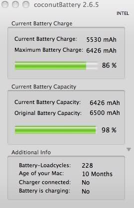

Hi,
I use my MBP all the time as I work on it and go online at night too. I have had it 10 months and have 228 load cycles.
I checked my battery health earlier and it was at 87%..not great, but manageable but I just checked now and it's gone from 87% down to 47%?!?! How is that possible.

Have you tried recalibrating you battery by draining it all the way? If it reads 47% again you are definitely going to want to get to fixed. A battery rated for 5 years shouldn't be at less than 50% after less than a year of use.

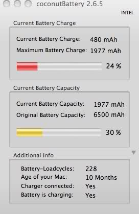

It's just gone down to 30 PERCENT!!!!!! So in a day it's gone from 87 -> 47 -> 30! 🙁🙁🙁 It now lasts less than an hour.
I called Apple and they said I need to bring it to them, they will test the battery and if it's faulty (which it obviously is!) and if it is they will replace the battery free of charge because of Apple Care.

Ok, I have the worlds weirdest battery ever. Now it's at 98%..it hasn't been that high in at least 2 months, staying at 87%.
I haven't done anything to it.
