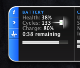

Disappointed am I with my battery's health. Just took a nosedive this past week. I can't use it for one hour without the unit shutting down.

i have the same problem, after only 11 month of use, 28 cycles my battery health is down to 43%. This is just ridiculous, fortunately my MBP is still under warranty.
