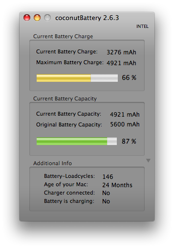

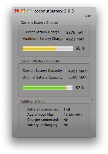

You should be able to get more than 4695mAh. My old MBP, which only is supposed to get 4 hours of battery life, has about the same mAh. And my battery is old.
With a new Unibody, you are supposed to be getting 5 hours of battery life. That should be more than 6000mAh. You might have a bad battery.
Here is my status on my old MBP for comparison:
The new unibody macbooks and pros have smaller battery capacities than the last generation... so it would not be more than 6000mAh.
The MBP's max charge for the new generation is 4600mAh...whereas the last gen was around 5600.
OP: Your battery seems fine...just check your Activity Monitor to see if there are any rogue processes hogging up CPU cylces.
