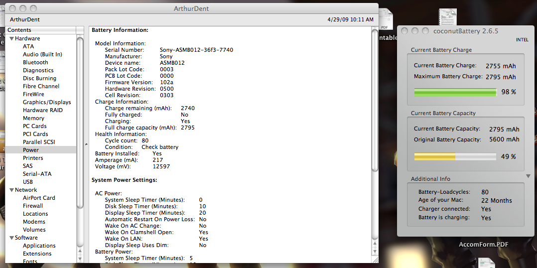

Your not the only one that is having a MBP battery acting up....my battery life has been fluctating between 89%, 60%, and lower, even after attempting to calibrate the battery....😱
attachment.php
How do you calibrate your battery? Or is that just something in this cocnut app so that it reads the battery more accurately?
