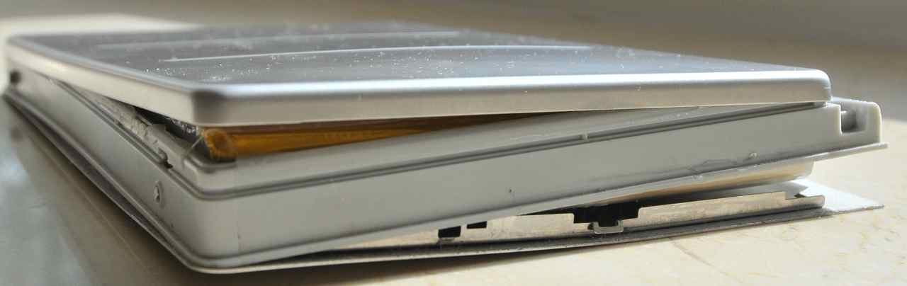

Be carefull.
|'ve got MBP 17" same age as yours. It took 2 weeks for battery to grow like that.
No chance for free replacement.
I hope you are not using ur laptop with that battery in it...
Apple might replace one of those... its very dangerous
