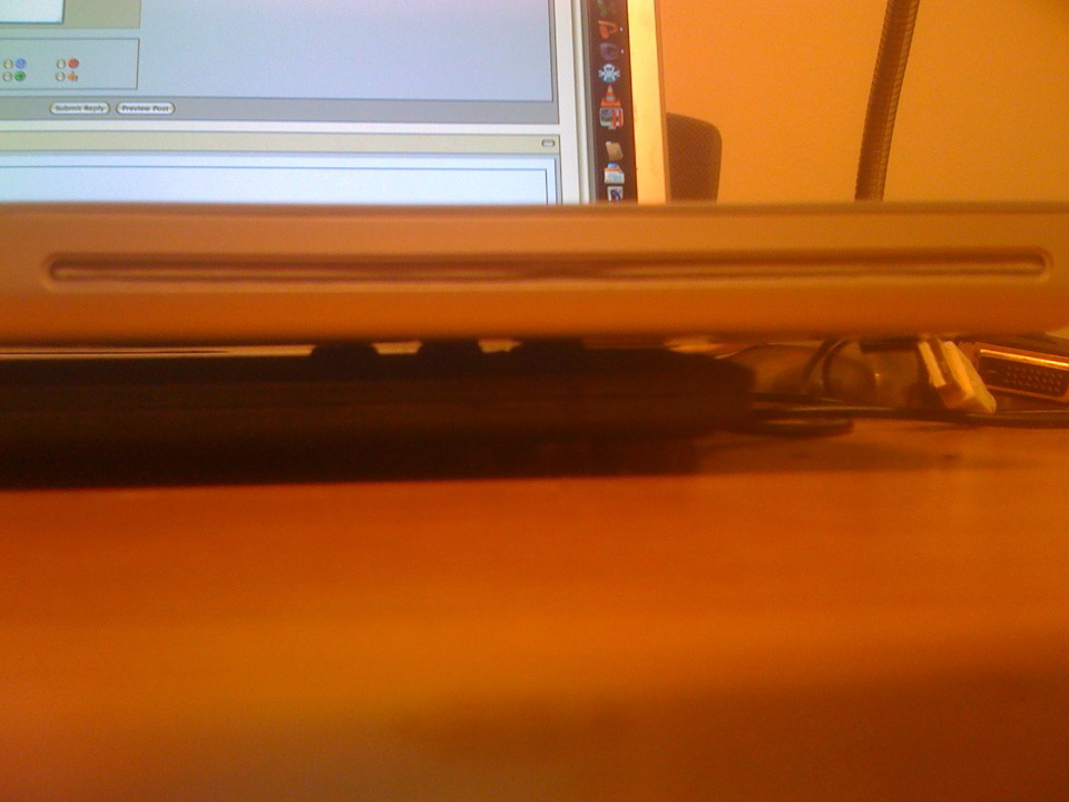

I just noticed today that my Cd slot is warped and bent. To see if it was jsut aesthetic i tried putting a cd which took a little bit of force. i then found that the drive was unable to eject the disk. Does anyone know a fix or if this would be covered under warranty? There was no event that led to this happening, i carry it around in my backpack all day, i cant imagine if it knocked by something or what.

from that picture it looks like the undercase warped. the top seems pretty level.
i dont think that is going to be covered under warrenty. i would say that a trip to an apple store is in order to see what they say.
you could try bending it back....carefully

Yes but really?

The top looks bent to me.
I believe this is one of the reasons they switched the Unibody's disc drive to the side as many drives were getting warped and bent from pressure daily from the resting of hands there.

it cant get any more messed up than it already is. but i would only do this after you hear from apple.
the reason the top looks bent i believe is an optical illusion. if you look closely u can see where the under casing has separated from the top.
Mine looked like that after I upgraded my hard drive. There are some clips there that hold it together, and they can be difficult to get back in after taking the laptop apart. What I did was wedge a bunch of paper (cardboard would also work, as long as it will not be crushed when you put pressure on it) in the slot, then press down on the top case. It took some force, but the hardest part was getting it to snap in without bending it more.

We are clearly not talking about the same thing. I saw the top as the top part ... giving no consideration to the "under casing" and considering the top of the slot the top and the bottom ... well the bottom. Therefore, when I say the bottom doesn't look bent in theory, I'm really referring to the bottom of the slot. Nevertheless, I see your point in the matter and if you were to remove that thin top casing I guess you'd be left with the bottom.
i cant imagine a way that this could even be done intentionally. my girlfriend had a crack on the faceplate of her macbook and they replaced it saying it was a known problem. then again macbooks are made of plastic, or at least used to be. you'd think the pro would be a bit more durable. i hope this is a known problem as well. i wont be near an apple store for a while though so i guess i'll just have to deal with no discs for a while, not that i even use my disc drive all that often.

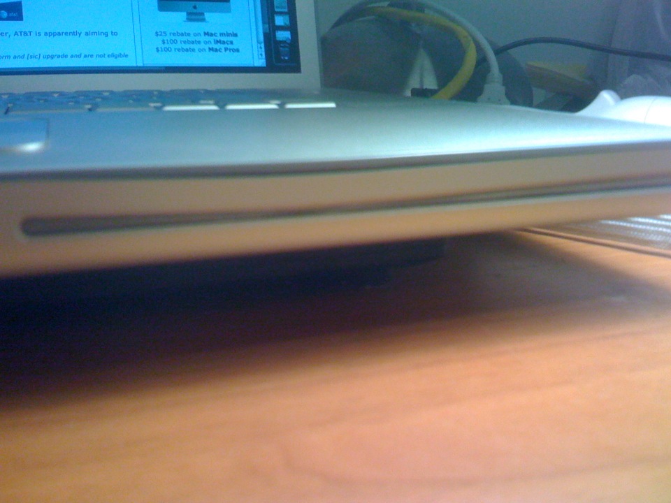

Took it to the "genius" bar. They said it's not covered under warranty, but they have a tool in the back that could bend it back for me. He said it's caused by picking your laptop up with too much pressure on top of the CD slot. It's a known problem. Works/looks perfect now.

No it was free. It was a kind of I can do it with your permission type thing, but no guarantee it will work. He never even looked up if i was under warranty. Plus he mentioned the same thing happened to his macbook pro twice so i guess he could sympathize with me. I'm curious as to what kind of tool he used to so next time i dont have to go back, not that i plan on doing it again.
It took him an easy 5 minutes in the back to fix.
