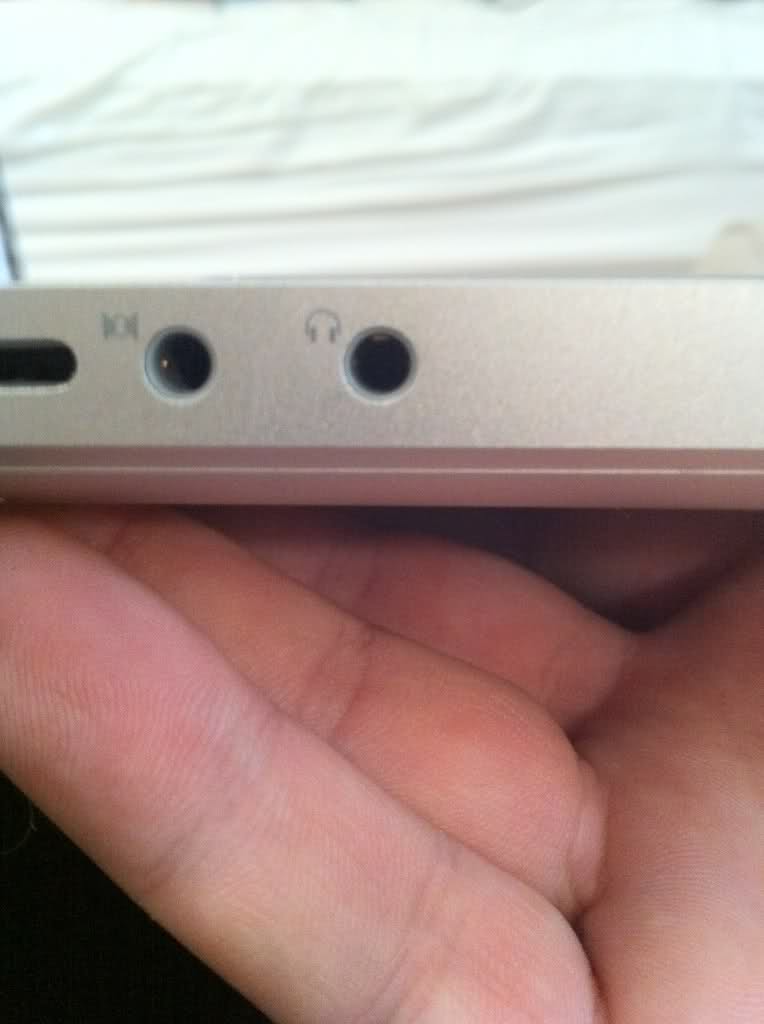

After installing a RAM upgrade, I can't get the bottom case to go back on flush on the left side under the ports. It's flush everywhere but there and I have tried reseating the cover to no avail. I've torqued the screws in the "star" pattern. The problem is I don't recall if it was like that before and I'm being hypersensitive and it's common or I should take it to Apple (if they would even do anything).
That's not too bad, but mine certainly is very flush. I'm guessing that's a 15" like mine due to the SD Card and Audio In/Out.

I suppose I can try again. One problem seems to be that the center screw on the left side does not seem to want to screw all the way in.

To give an update, I loosened the screws again,switched a few around, and pushed kind of hard on the case as I was screwing and I think it's about as good as I can get it. Pretty close to as flush as the right side. It might be that there is some slight warpage to that bottom case or something. Oh well, the computer works great so that's what matters.

I will say that I'm a certified technician and that it looks fine to me. I have worked on 30 of these and that bottom looks about as flush as it will get. Here's the location of the long screws vs short screws:
===Back===
-s--L---L---L--
s--------------s
-s---s---s---s--
===Front===
I think you are worrying a bit too much about it. That's my opinion though. Good luck.
