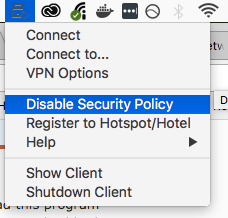

I have Check Point VPN-1 SecureClient installed on my Mac to work from home. I thought I had this program turned off, but I guess some of its processes run in the background too. Anyway, all I had to do was disable the security policy that it enforces.

I just spent 3 hours debugging the same f***ing problem. Here's an image on how to disable the stupid Security Policy (right click menu bar icon > Disable Security Policy):

thanks guys. I'm also facing the same problem, firewall is turned off but apparently checkpoint vpn is still there. After uninstalling checkpoint vpn completely I solved this problem.
