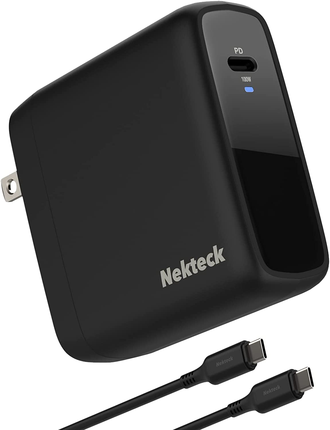

I've seen that with third party chargers. I think they sometimes work but don't provide the "something" that the MacBook is looking for.

Could be the USB-C connector end of cable has expanded and making poor contact. This has happened to me a few times and was able to save a USB-C to HDMI dongle. Hold the connector horizontally with one hand and try pinching the top and bottom of connector with thumb and index finger. Otherwise, you can get a replacement cable from Ikea for $6.99.

I got a new USB C cable and the repeating charging sound when off is fixed.

New cable fixed this issue

I had similar problem with a 3rd party cable as well. It's weird ... I've had bad cables more in the last few years than all the years I've ever used computers. Last few years I've had several bad cables. One that melted on my lap... one that did what the post here says... and one that just died and refused to charge.
Now, sadly, I'm relying on super expensive Apple cables for the most part.
I've noticed that most of my 3rd party USB C cables top out at around 60w.
I got a like new 100w Anker cable and the laptop doesn't do the repeating charging sound now.
