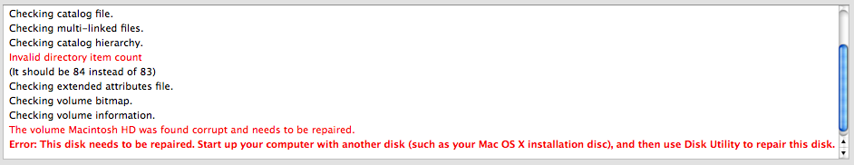

According to the disk utility, the startup disk is corrupt. I have tried to repair it in single user mode using applejack and fsck but I still get the same error message:

There is no difference between using Disk Utility (from a installer disk or external drive) and Applejack in single-user mode...so...you've done all you can do in that regard.
It's possible that your hard drive is OK and that the third-party app "DiskWarrior" could repair the directory but I'd say just get a new drive since DW costs $120.
If the disk is damaged/dying this is a time sensitive matter. You need to be backed up and if you're not you should probably proceed with getting a new drive right away. This may be an opportunity to upgrade to an SSD!
Looks like you'll need to get an external DVD device (Just about any will do. No need to get the high-priced Apple one) no matter what the situation. So, if you're backed up, get the new DVD drive, reformat the old drive and check it with Disk Utility. If it checks out OK it could still be bad, though. Only a thorough scan of all the blocks on the drive by another third-party app will let you know. However, if it checks out OK you can go ahead and reinstall and recover from your backup. If problems reappear you can get a new drive.
If you're not backed up get a new drive right away as well as an external housing or USB to SATA connector (so you can get your files off the old drive). If you get an SSD you'd better format it first using the external housing or connector before taking the original drive out of the MBP.
Swapping drives on a MBP is easy and you'll find the instructions at iFixit.com.

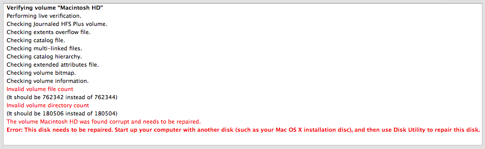

I ran the disk utility again and now it's showing more errors than it was before I reinstalled OS X! Even though there were no errors immediately after reinstallation!
I'm assuming this means the hard drive needs to be replaced? I was so hopeful when there were no errors after reinstall...
The problem is that when your MBPro crashes/locks up, and you have to force power off, that always runs the risk of corrupting directories, or individual files.
I think that a disk repair should always be the next step after a hard crash. Often, nothing is repaired, but sometimes you will stay a step ahead by fixing some minor issues, before they become more "challenging"
Now that you have a working DVD drive, boot to your Snow Leopard installer, and run Disk Utility from the Utilities menu. Try a Repair Disk then.
It's very possible that won't help, but you should try it now....
If that doesn't clear out the Disk Utility remarks, then you should:
Backup - if you still need to backup - to another drive.
Boot to your installer DVD, Erase your hard drive, again using Disk Utility.
Quit Disk Utility, reinstall OS X, and restore all your stuff.
Takes some time to do right, but you should have less problems, and likely a much smoother/faster system when you are done.

its been a while , but does disk utility show smart status?
if its "verified" then it can be salvaged by erasing ( a full 1 pass erase ) the hard disk and reinstalling or running disk warrior. if says "failing" or "bad" i forgot what the error was, then its bad, and it should be thrown out
if it says "not supported" then you need to run more tests to see if the drive is bad, like seagate's free sea tools utility on a long hard ware test
smart status also shows up on system report, if you call up system report and check the hard disks , you should see an entry for smart
when erasing the hard disk you want to do a single 1 pass erase of 0's . this is called a security erase and it will find bad sectors.
hard disks for the last 21 years lie to the operating system when it comes to bad sectors. all hardware disk errors on a computer's hard disk are fixed on the fly, and corrected and the operating system is never told.
if it was an actual hardware error , like bad sectors, and the operating system found out, then the drive is shot
if it just lost clusters, then you need to find some way of booting the computer maybe on a usb key, so the disk isnt mounted, so the lost clusters can be repaired
disk warrior costs a lot of money , its cheaper to just erase the hard disk and restore from time machine.
if you don't have a time machine backup , now would be a good time to make one
if it finding new errors, then it did last time, then it means that the hard disk is completely shot and should be replaced.
please do us a favor and recycle your old hard disk and do not throw it in the trash, heh
don't buy any software to check the condition of the smart sensor. your mac should already tell you if its bad for free, and you don't need to know the reasons why. all you really need to know is the drive serial # and whether or not that drive is still under warranty. hard drive companies will cover a drive that has failed under warranty, (typically 1 to 5 years ) but they want you to run their hard disk tests, like sea tools
Another update
It's not the hard drive.
I tried installing OS X onto my external hard drive and booting from there. Same exact issue.
Could be the RAM or another issue but the GPU Graphics Switching sounds likely to me. There was some good info about it on this thread: https://discussions.apple.com/thread/6486181
