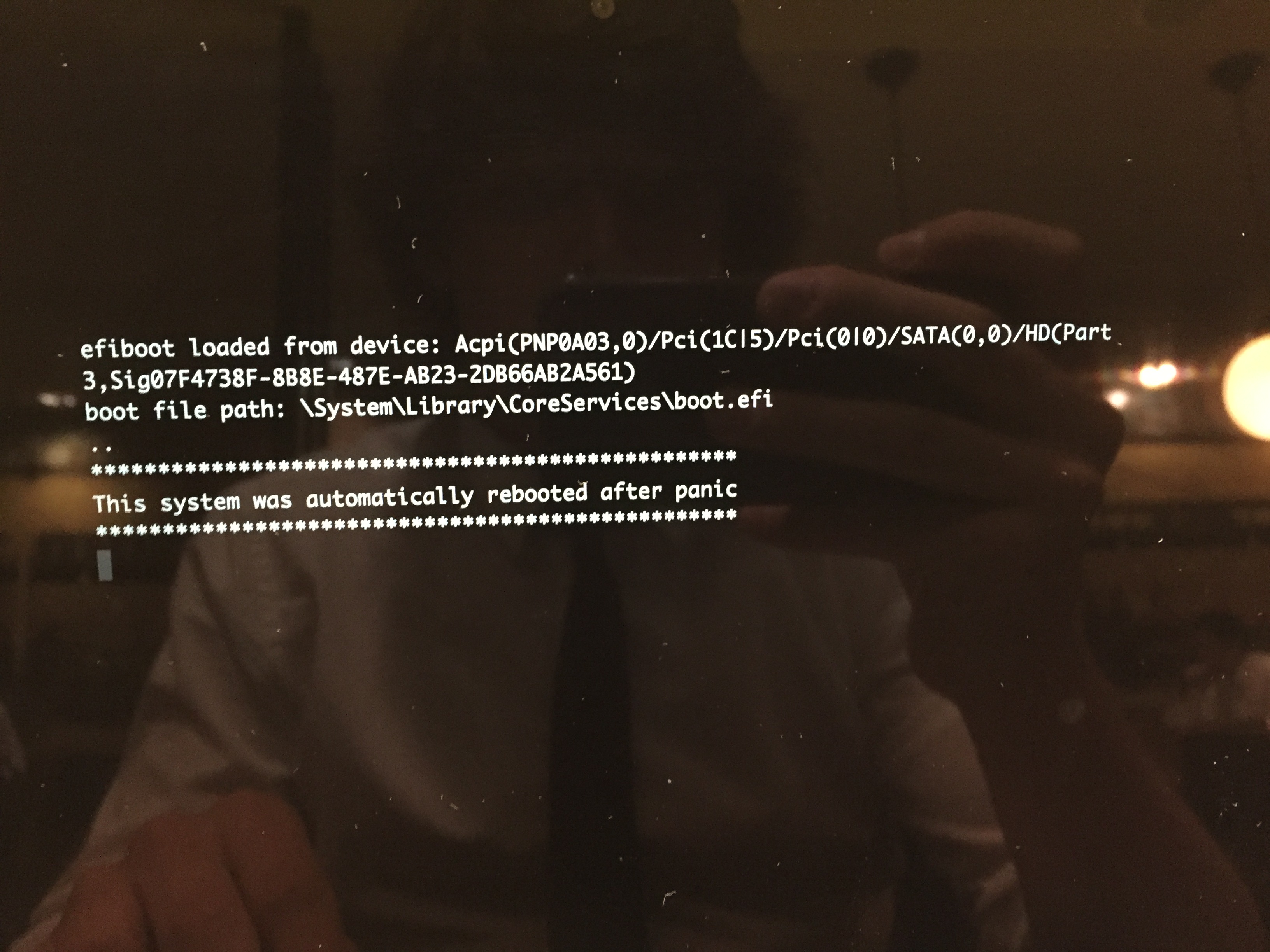

Later in the day I tried to actually use the MacBook but when it started up the apple logo appeared with the progress bar, which only progresed a millimeter before some code emerged in the top left hand corner.
I tried a series of reboots. Safe mode wth shift, control + option + r + p, etc. command + s simply got more source to pop up, but in the end nothing seemed to work.

Below you can see the code that emerged when it failed to boot the first time today.

looks like the problem is there are too many 'f's in your kernel... try removing some of your memory chips
