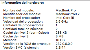

Maybe it's helpful for the reader to get some more info about your MBP.
If you go to: "about this Mac"> hardware info and post a screenshot(without Serial Number), people can see the exact model and BootRom version.
e.g:
