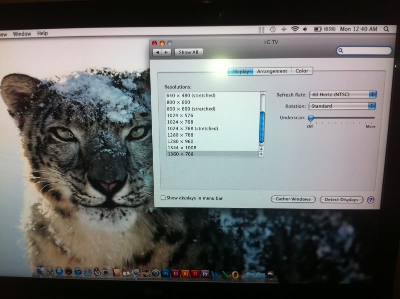

Are you saying when you plug in your tv, you see nothing on your laptop screen when mirroring is off? If so, that is strange. If you use something like gfxCardStatus make sure you are not on "integrated only". Look in System Preferences under Displays and click "Detect Displays". Play around with resolutions

...Are you saying when you plug in your tv, you see nothing on your laptop screen when mirroring is off? If so, that is strange. If you use something like gfxCardStatus make sure you are not on "integrated only". Look in System Preferences under Displays and click "Detect Displays". Play around with resolutions

If my underscan is greyed out, I'm guessing that could have fixed my problem.
