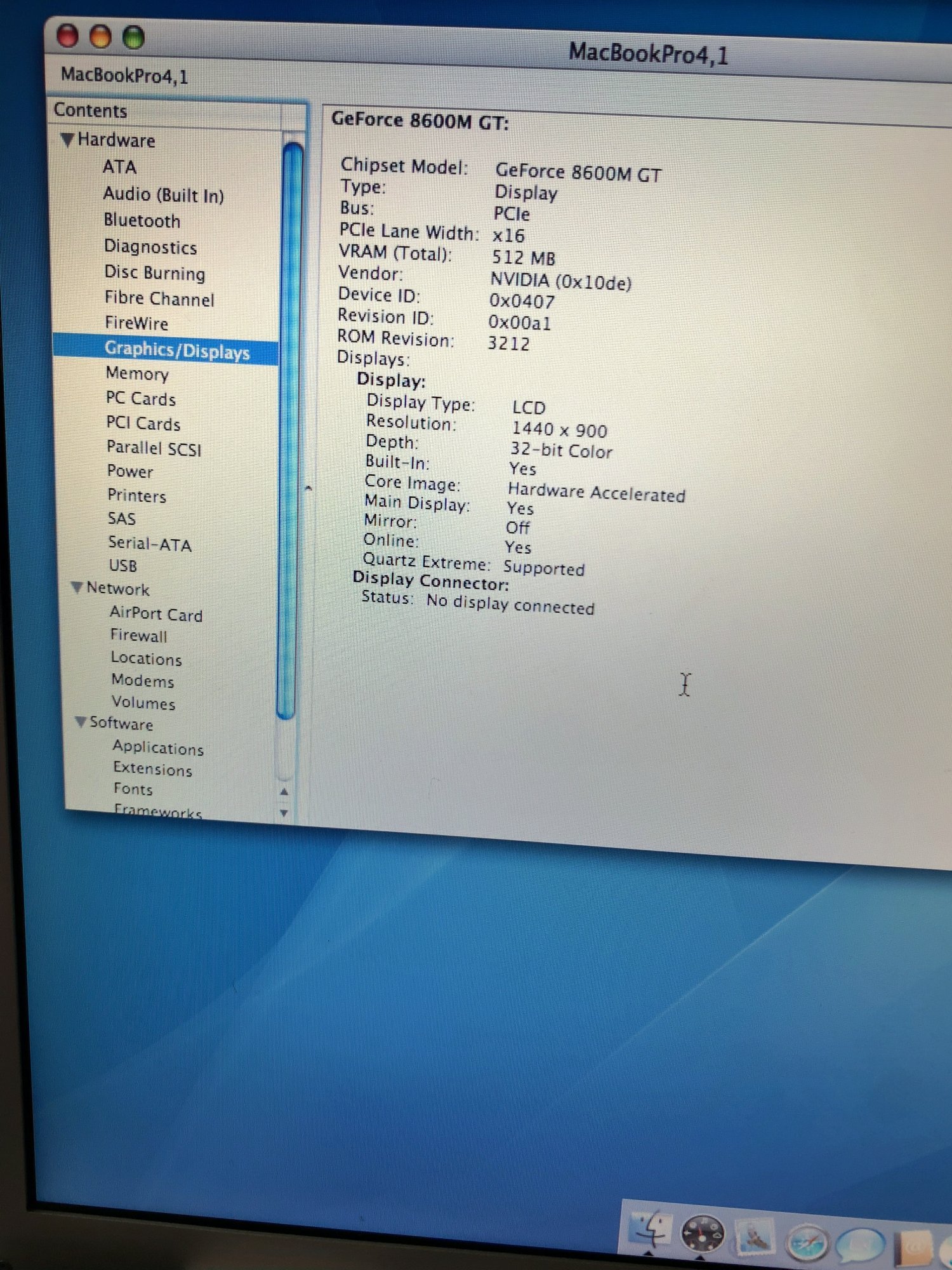

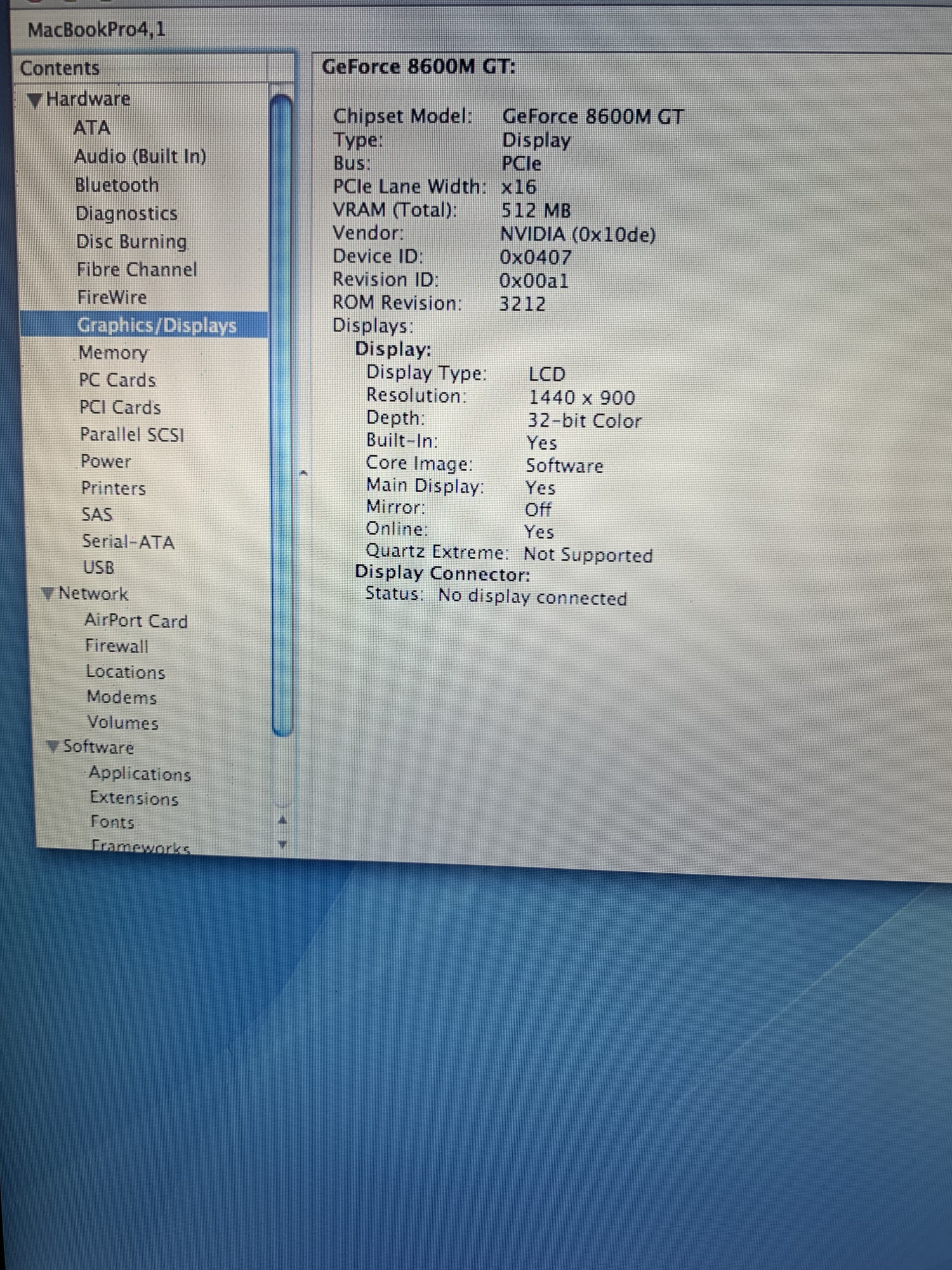

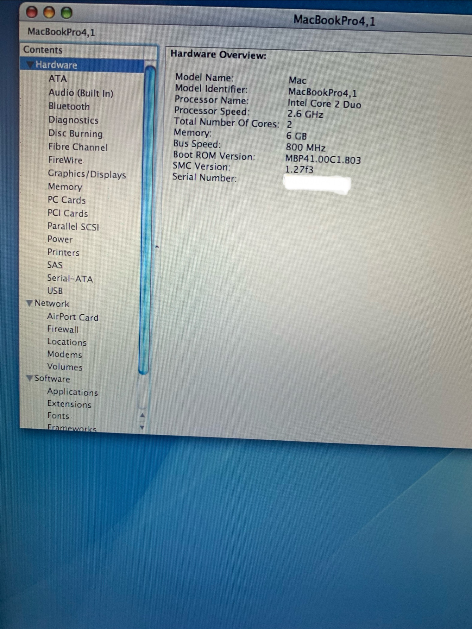

The problem seems to be temporarily resolved.
It was not resolved.
It just happened to work luckily.
edit:
I installed MacBookProSoftwareUpdate1.1.pkg and edited the info.plist of GeForceGA.plugin.
10de0100 to 10de0407.
Then I held down C to boot and it worked fine twice.
I am not sure if this procedure is causal or not.
However, it is working.
Higher temperatures seem to increase the probability of freezing at the boot screen.
I have installed OS version 10.4 to 15 using OCLP and Patcher, but these problems are only in 10.4.
I wish I could specify a range of temperature control by editing kext, etc., but this needs to be researched.
edit 2:
edited the info.plist of ACPIPlatformPlugin.kext.
MacBookPro3,1 to MacBookPro4,1.
not sure which was the correct procedure, but it is working fine now.
1.First boot was set up in safe mode.
2.Edited the info.plist of GeForceGA.plugin.
3.Edited the info.plist of ACPIPlatformPlugin.kext.
4.Install MacBookProSoftwareUpdate1.1.pkg
Before the board was replaced, these steps were not necessary.
