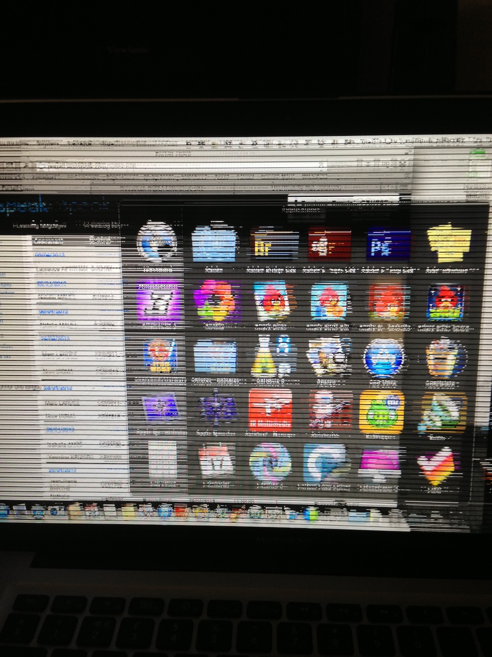

Hi,
I am having an issue with my MacBook Pro since last week. My CPU runs up to 95-96 degrees and when I try to launch an application the app freezes due to this high temp.
When I restart I sometimes have the grey start screen with the apple logo that shows up some scan lines... After displaying this grey apple logo I remain stuck in the grey screen. The fans then run at high speed and the mac shuts down 2 minutes later.
Then when I restart there is no problem. It starts perfectly and really quickly too.
For the moment I have a CPU temp of 56.
When I use a software as Webex the screen starts to flicker and I have to restart then.
Is it a problem with the logic board? Do I need to apply some thermal paste.
For the moment I am using my mac without any problem.
What could it be?
That would be great if I could get some help to solve this out 😉

Looks like a heat problem. Take it in for AppleCare service.

Here are the panic logs: Last occured on the 04/22.
My mac had the problem I described earlier this morning.

One of them seems to be Graphic (GPU) related, not this does not necessarily mean it is hardware, I do see quite a few of these lately, could be OS X graphic driver related.
The best way to test out if it is indeed the OS which causes this problem is to install a temporary OS on an external and boot from it.
The best way is to install a different OS version than you have now, best is the original OS since this is I think the least to cause problems.
Even a USB stick (Minimum 8 GB) would do although it will be slow.
If it is stable there it is the OS causing the panics.

I have noticed a strange behaviour on 10.8.3 though.
I turned on Photo Booth earlier and it switched to the AMD Radeon Graphics. The screen then started messing up being fractioned in 2 half.I closed Photo Booth it switched back to the Intel graphics and everything was ok then.

I've installed snow leopard and I have the same problem. It only seems to happen when I switch to the discrete graphic. The only workaround I have found for the moment is to install gfxcardstatus and forcing to the main board GPU.
My GPU is certainly dying.

That's a 2010 model, if that was the case you could still get it repaired free of charge.
