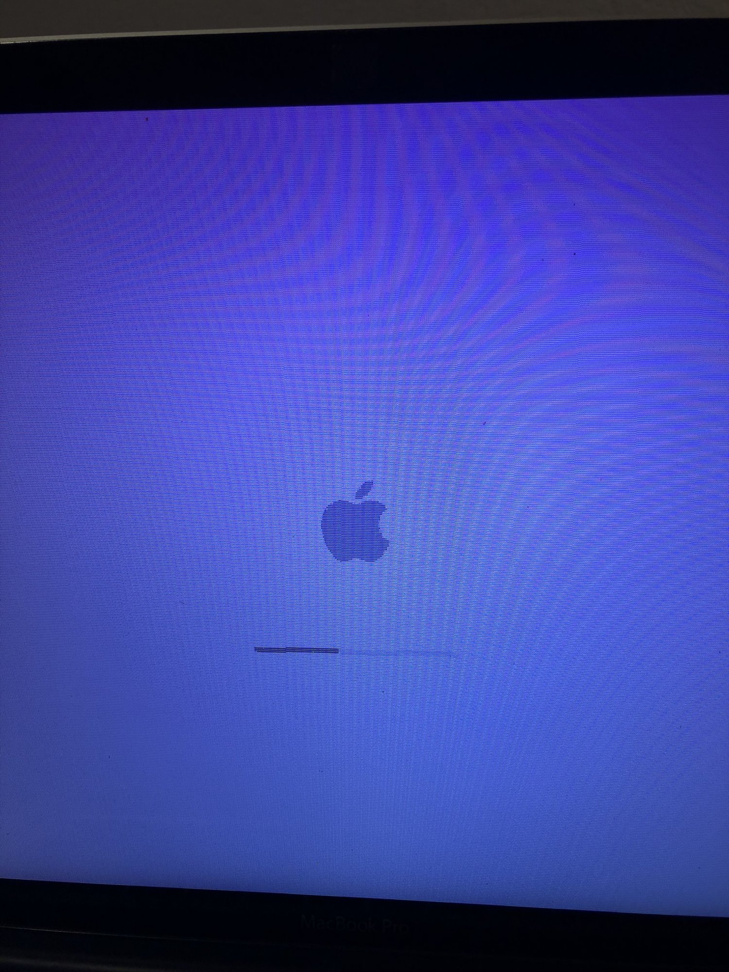

So today I wanted update one of my partitions that had El Capitan on it to High Sierra. The install went fine and I proceeded to migrate from a back up. After it was finished, it reboot and that’s when it all went south. I’m stuck on the grey screen and the Apple logo has horizontal lines and the progress bar is not straight. While migrating, I was using a laptop cooler with fans underneath, but it was still pretty hot.

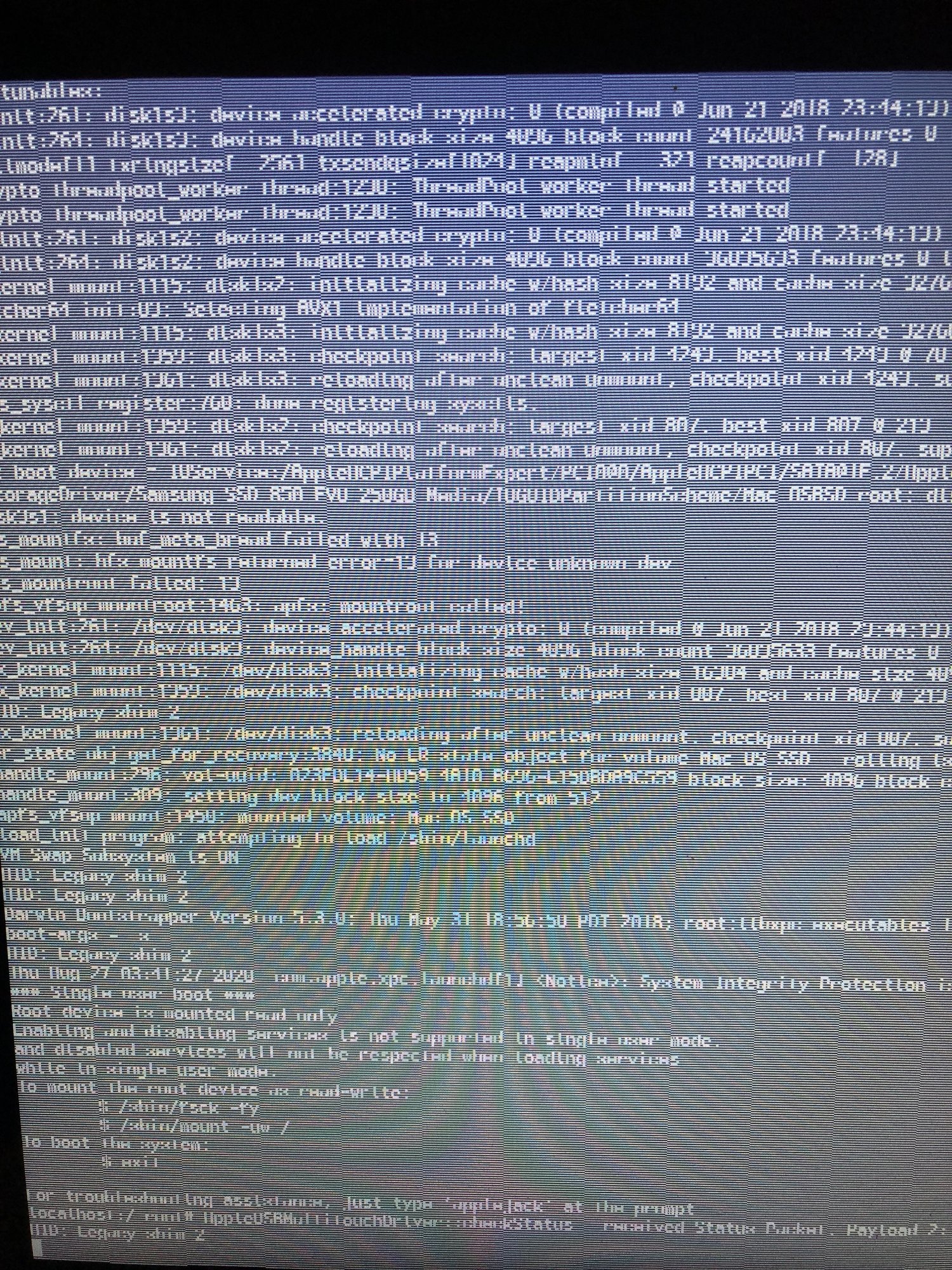

I’ve tried all the resets, fans are both running and I tried booting from a different partition. Also to note, I’ve been using the gfx switcher app for years and am usually on the Intel graphics, so the AMD chip was hardly being used.
Is the AMD chip toast? Very odd because even before all of this, I didn’t have any early warning that the chip was on its way. No flickering, lines or black screens. Now I’m regretting redoing the thermal paste. I definitely didn’t put as much as Apple globs on, but I covered the surface well and tinted the heat sinks.

The grey screen is a completely normal console output for a booting unix system. Remember MacOs is a unix system at the bottom.
This console is normally hidden behind the blue boot screen. I assume if you look at the end of the fairly long list you have a fatal error message. What is it?

Yup. This is a symptom of discrete GPU failure. Exact same thing started happening with my 2011 (lines in the display) before it failed completely in a similar manner. Yours has done well to live this long - mine died in 2015. I also ran gfxcardswitcher and avoided the discrete GPU as much as possible.
If you had SSH or Remote Desktop enabled you will be able to log into the machine from remote over the network. The machine will be booting past that screen but basically what happens is it boots on the internal display, then initialises the discrete GPU and starts displaying (or attempting to) on that or something and it fails, leaving the boot screen on th display even though its past that point.

I purposely booted in single user-mode and posted the second pic to demonstrate how the graphics look degraded. You have to zoom in.
