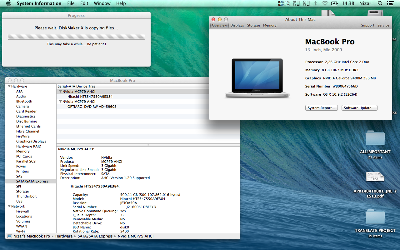

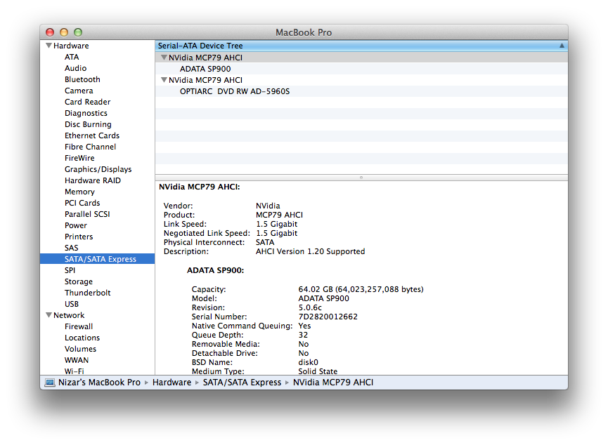

Hi, I upgraded my 500GB Hitachi sata 3Gb/s on My MBP 5.5 to 64GB SSD ADATA SP900. When I was using Hitachi, both link speed and negaotiated speed was 3Gb/s, under EFI 1.7. However, when i upgarade to SSD, the link speed was 3Gb/s and negotiated link was 1,5Gbps. I did the downgrade to EFI 1.6 then. Surprisingly after downgrade, both link speed and negoatiated speed are 1,5Gb/s. Is that mean EFI 1.7 works better than EFI 1.6? I m using 10.9.2
Hitachi HDD + EFI 1.7 + 10.9.2

SSD + EFI 1.6 + OSX 10.9.2
