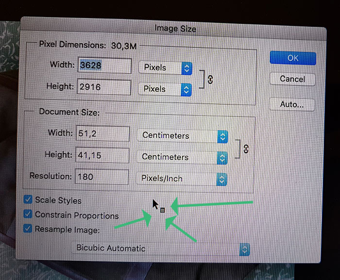

When I use photoshop there's a little square next to the cursor which make me think that there's a key that is failing like it was stuck.
Any clue on which key it may be?
That icon is caused by holding down the control key. I have a 2013 MacBook Air and used to follow those forums closely, but rarely use the MBA anymore and no longer follow them. But in those days there were quite a few threads where people did serious damage by cleaning their keyboards with alcohol just as you describe, unfortunately.

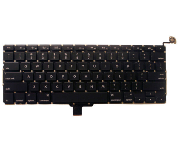

There are replacement keyboards you can get for a 2009 MBP, but be warned that replacing a keyboard on most laptops is not for the timid of heart:

If you think the control key is the only key that's messed up, you could try remapping the key. Keyboard preferences has some vary basic remaps you can use to swap the control key with caps lock. Give that a try. You might be able to use your keyboard again.

Yes, I did. I watched a diy video on youtube.
How long did it take? From the walkthroughs I saw, it looked like a pretty gruesome task.
I've never replaced a MBP keyboard before. I've done it on a Sony Vaio and I swear there wasn't a part of the laptop I didn't have to disassemble just to get to the keyboard.
It took like 20 minutes but I had to do it 3 times because I forgot a part outside the first time, misplaced a part the second time and so on. The keyboard is held by 51 tiny screws and 2 of them were impossible two unscrew so I had to break those. You must take everything apart since the keyboard is underneath the motherboard.
