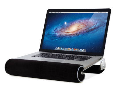

For use on the lap try iLap by Rain Design, don't expect miracles.
