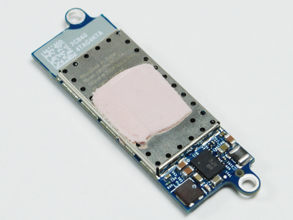

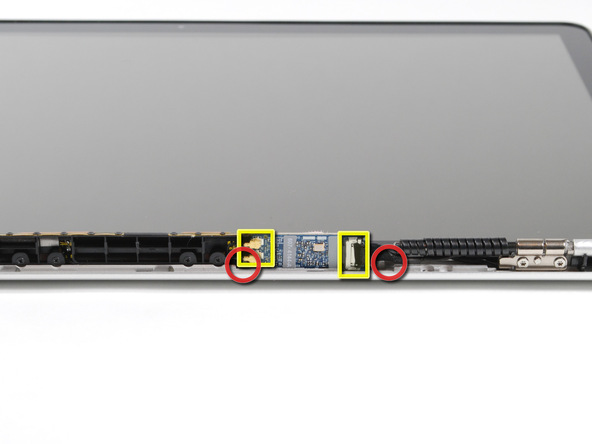

The Airport card is not soldered to anything. It's in the display clutch. First thing you want to do is make sure the cable from it, to the logic board is seated.
http://www.ifixit.com/Guide/MacBook-Pro-15-Inch-Unibody-Mid-2009-Optical-Drive-Replacement/1728/3
There is the cable. They call it the camera cable but the Airport card runs through this as well. Reseat carefully. If it still doesn't work, it may have come loose on the other end which is a lot more difficult to get to and you're probably not capable of checking.

The image in Fixit, is not the same as the 09 variety..That's a separate card you show there.
It's not. its a hardboard solder. As far as I can see, that year was the turnover point. I hope you're right for the OP's sake.
http://www.gomacpro.com/unibody-macbook-pro-airport-extreme-card-661-4766/
As far as I know, the wireless card stayed the same from the Late-2008 until Mid-2009 revision MacBook Pros with the BCM4322.
The card changed with the Mid-2010 MacBook Pros, and then again with the Early-2011 revision.
For the second time, it's not soldered. I am an ACMT and I work on these things daily. Believe me, it's not soldered.
