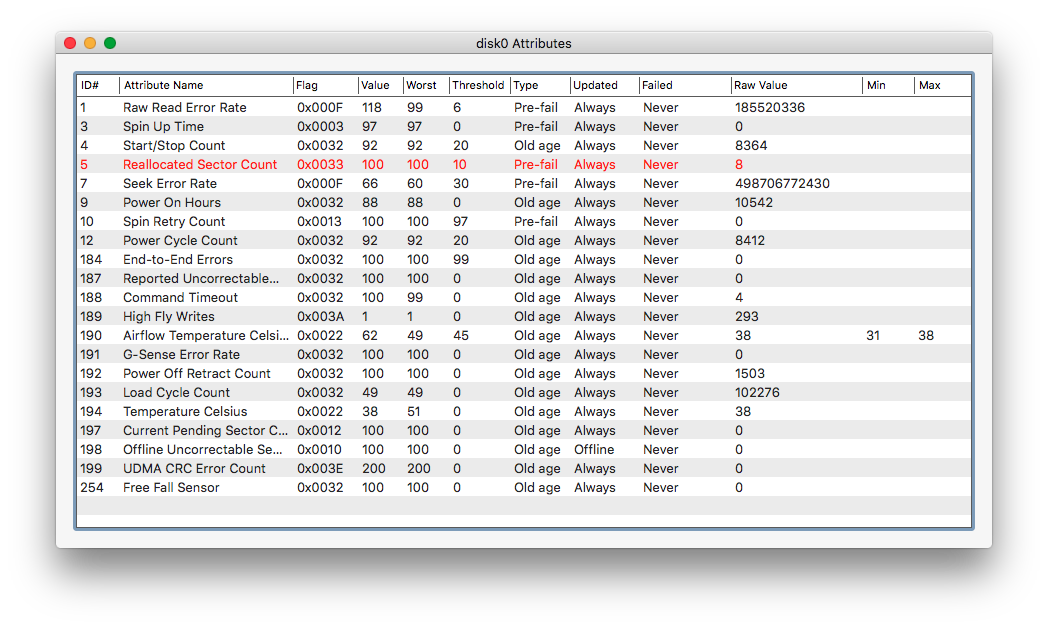

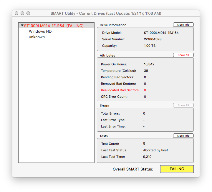

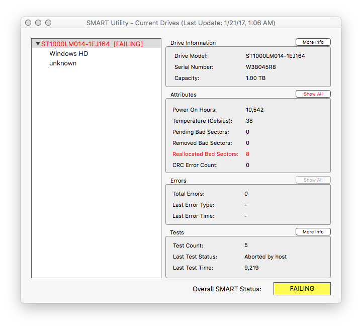

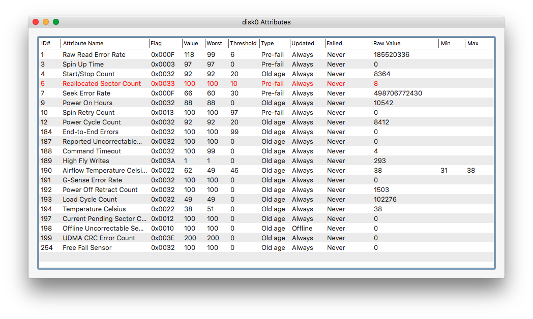

It didn't say Passed. It said Failing and the specific error was "Reallocated Bad Sectors: 8." Nothing else was in red/showed an error.
My hard drive is only about 3 years old - I wouldn't think it'd be failing this quickly. (Here's the specific hybrid drive if you want to look at it: https://smile.amazon.com/gp/product/B00B99JUBQ/ref=oh_aui_search_detailpage?ie=UTF8&psc=1)
What does the specific error I got mean, and why would it cause the computer to act up sometimes, but not all the time? And do you think it is the hard drive if the problem is (currently, don't wanna jinx myself) fixed after swapping RAM and clearing PRAM/SMC five times and resetting battery?

Yeah it looks like the drive needs to be replaced. In all honesty, 3 years isn't unusual for a drive to fail. The trouble with hybrid drives is that they still rely on the ancient HDD technology in addition to an SSD cache.
Hard-drives almost work similar to a record player. You have a needle which scrapes away, reading data from a platter. It's a clumsy and slow process. It means that drives are susceptible to drops, knocks, or even fail naturally over time due to wear and tear.
Your best bet would be to replace the drive with an SSD (I'd recommend Crucial or Samsung). There are no moving components in SSDs, so you don't risk losing all your data if the drive is dropped. They're also significantly more reliable and infinitely quicker. Load times will be ~15 seconds from a cold boot and applications will open almost instantly.
Also, SSDs are a lot cheaper than they were 3 years ago! The days of £1/$1 per GB are long gone. 🙂
Reallocated bad sector are faulty sectors on the hard disk that has been detected by the disk drive and flagged as not to be used. Data has been reallocated to other sectors. Potentially data may be damaged.
A few such sectors is OK, the 100 you have is really bad.
In my experience this typically indicates a rapidly failing hard disk. You should have it replaced immediately!

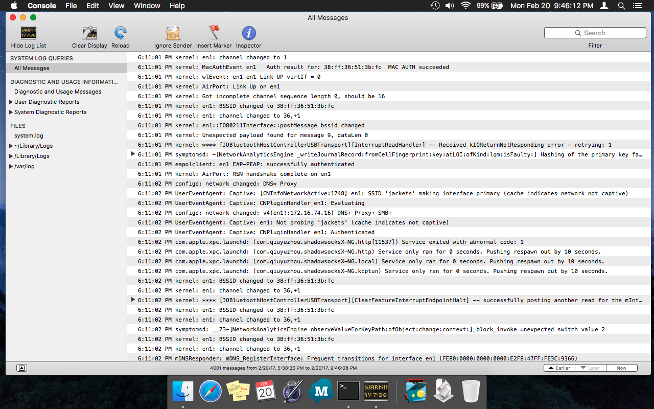

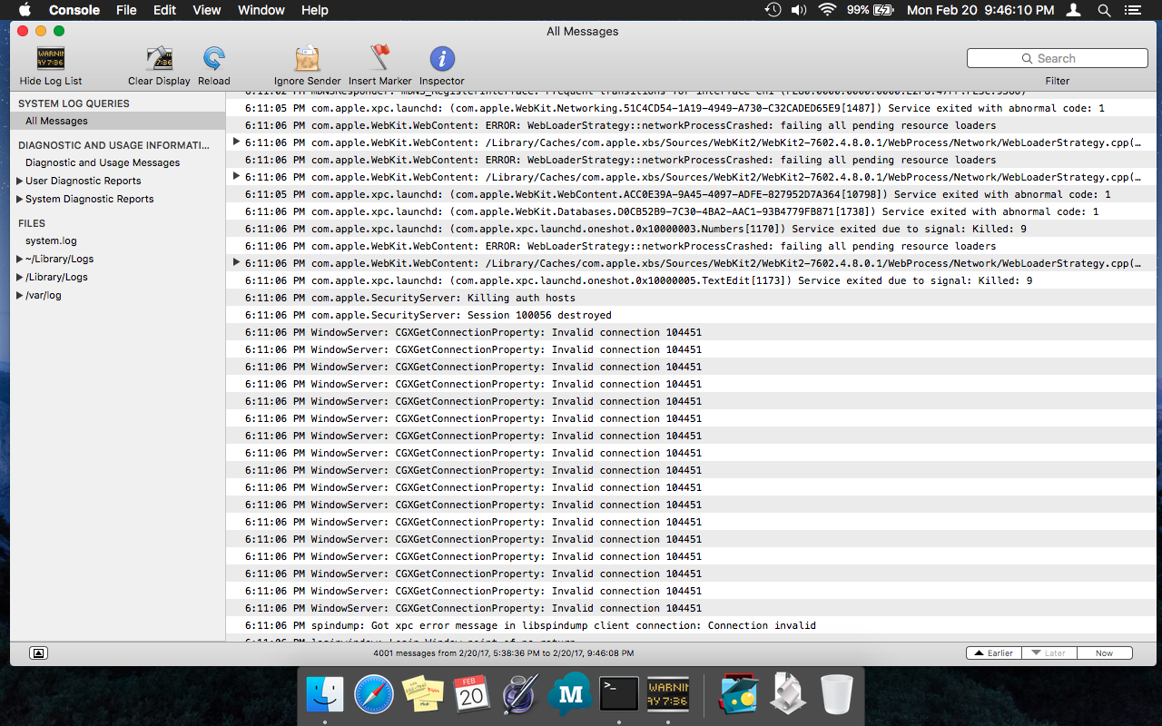

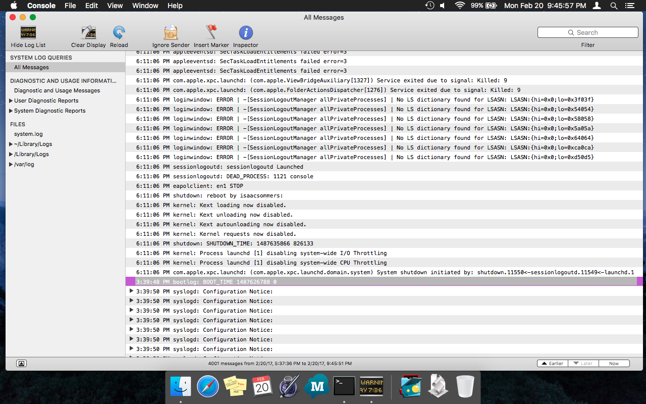

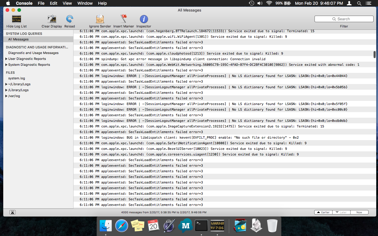

I've tried just disabling all the startup apps and it doesn't seem to do anything. I got a few screenshots of the Console log immediately before I forced it to shut down but I can't tell if there is anything in particular that made it freeze as I'm not familiar with the Console.
