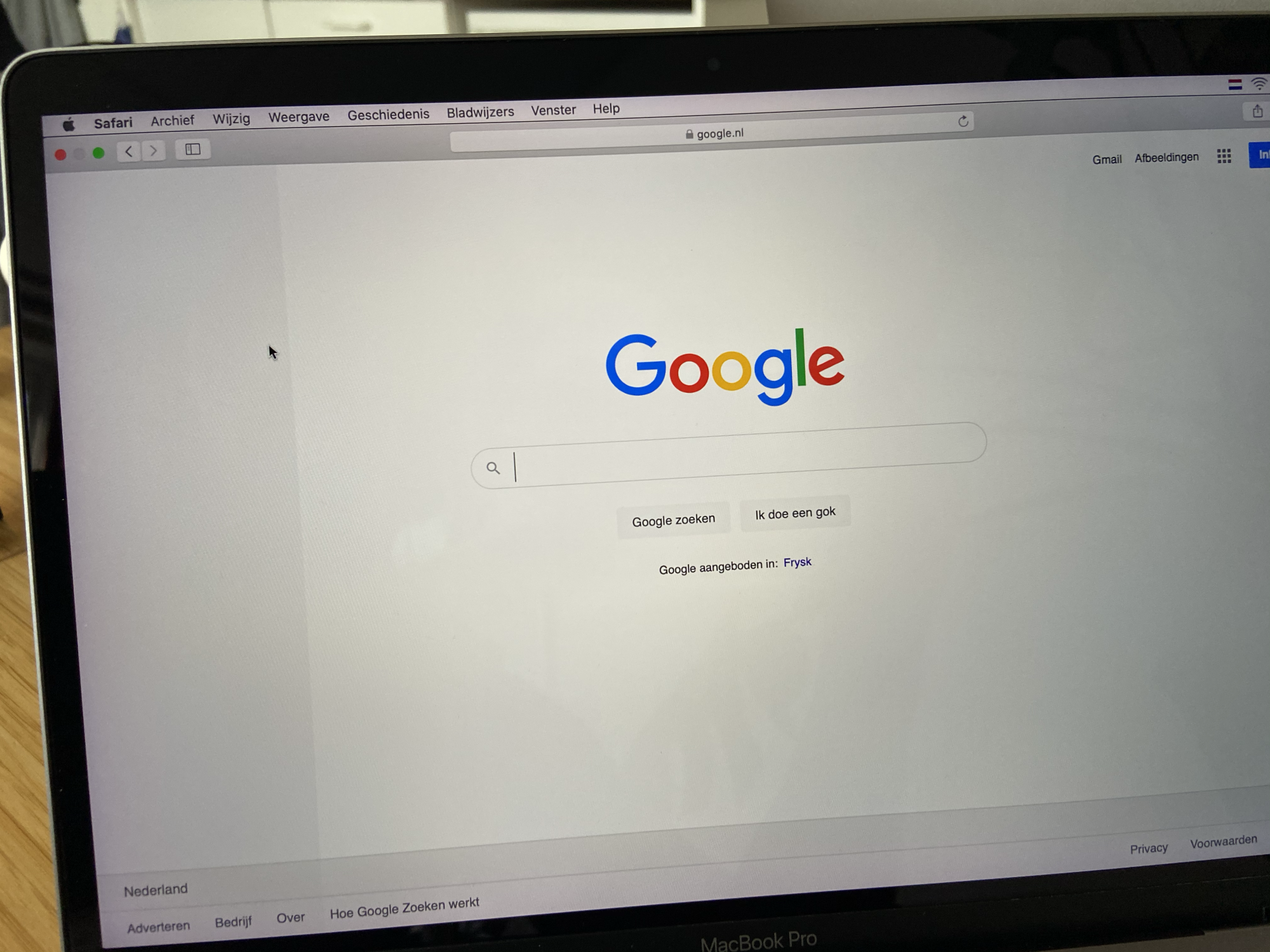

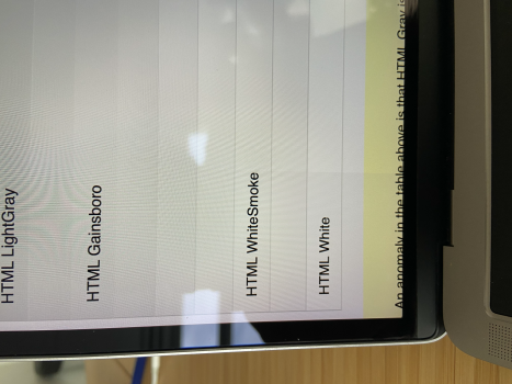

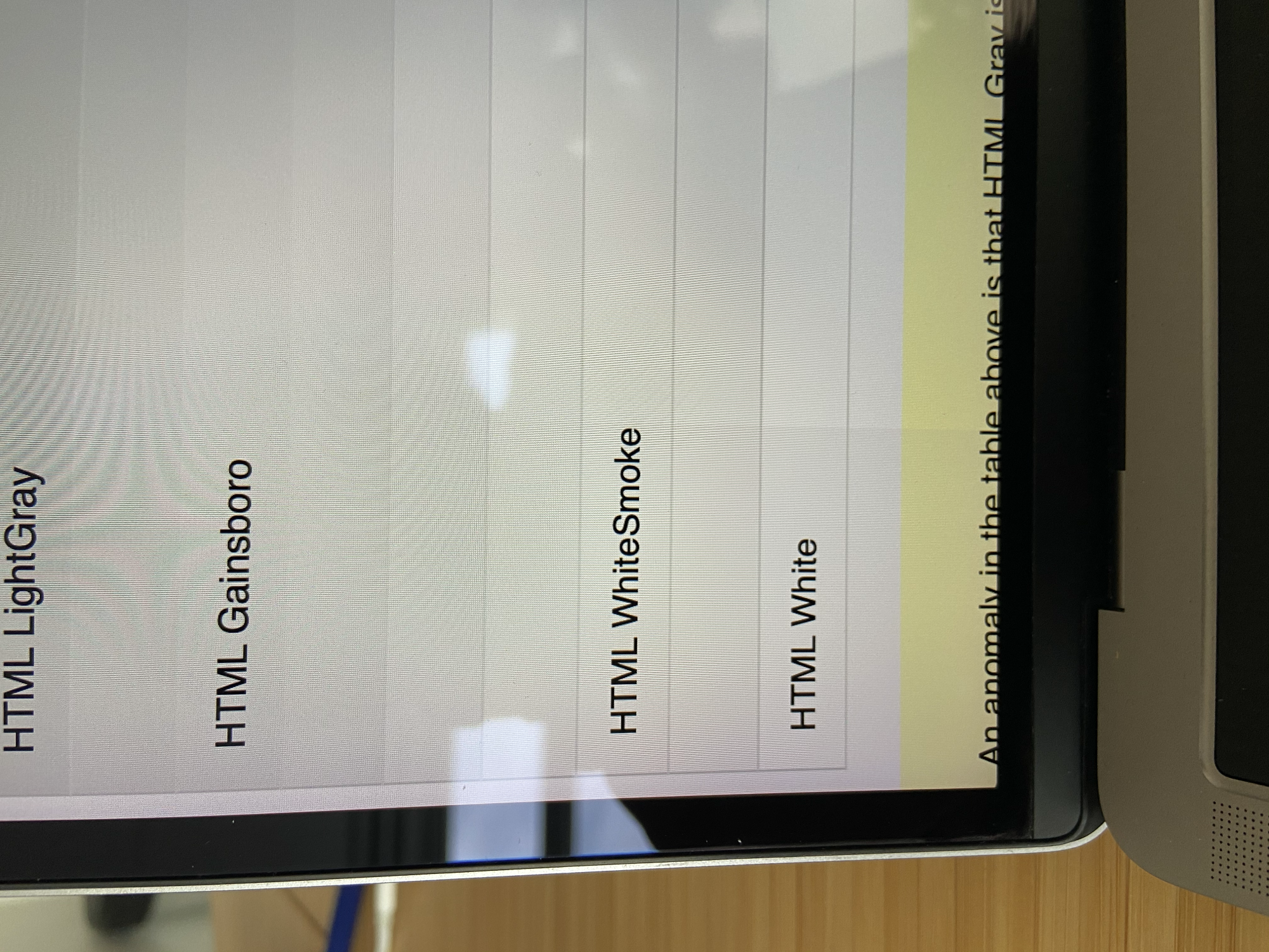

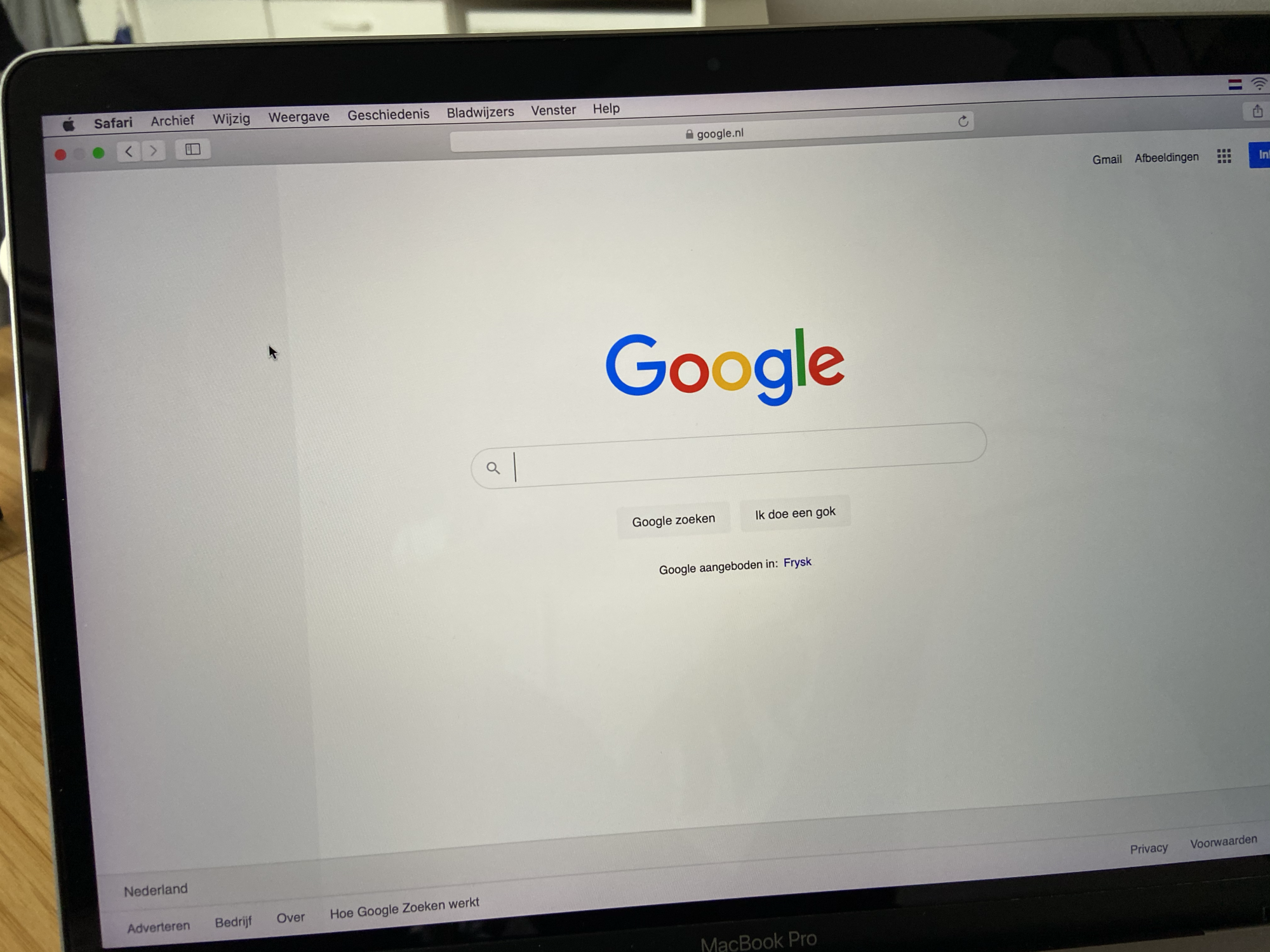

The photos attached are of my girlfriends MacBook which is from 2017. The grey bar mostly shows up on white and very light grey colours. On a lot of colours it seems to be non-existent. Does anybody know what this could be? Since it is dependent on the color on the screen it doesn't seem to be the backlight. I opened up the MacBook, cleaned and reseated the display cable, so that isn't it either.

And if you press lightly on the side of the display, does it change somewhat?
Also, was anything sitting on the laptop prior to this happening?
Pressing does not seem to change anything. Also nothing was sitting on it. It has taken a fall inside a bag once, but the fall only damaged the bottom case and on the other side as well.

We wiped the whole pc and it's still there. It's also present in recovery mode. The weirdest thing to me is that it only shows up on light colors. So that means it cannot be a backlight problem, that would dim every color equally in that region (also I don't think the macbook has local backlight, right?). So I'm kind of at a loss what it could be. As far as can see, the display has taken no damage at all.
(also I don't think the MacBook has local backlight, right?). So I'm kind of at a loss what it could be. As far as can see, the display has taken no damage at all.
Not sure about the backlight answer. However, if you use the keys on the keyboard to make the screen brighter/darker, do you see any differences?
Also, as a test, set the Desktop wallpaper to colour only, and choose black. Then see if you can still a part of it showing 'grey', versus full black. Try with another colour, too. Based on the results of this, the issue is more than likely hardware, versus software/drivers...

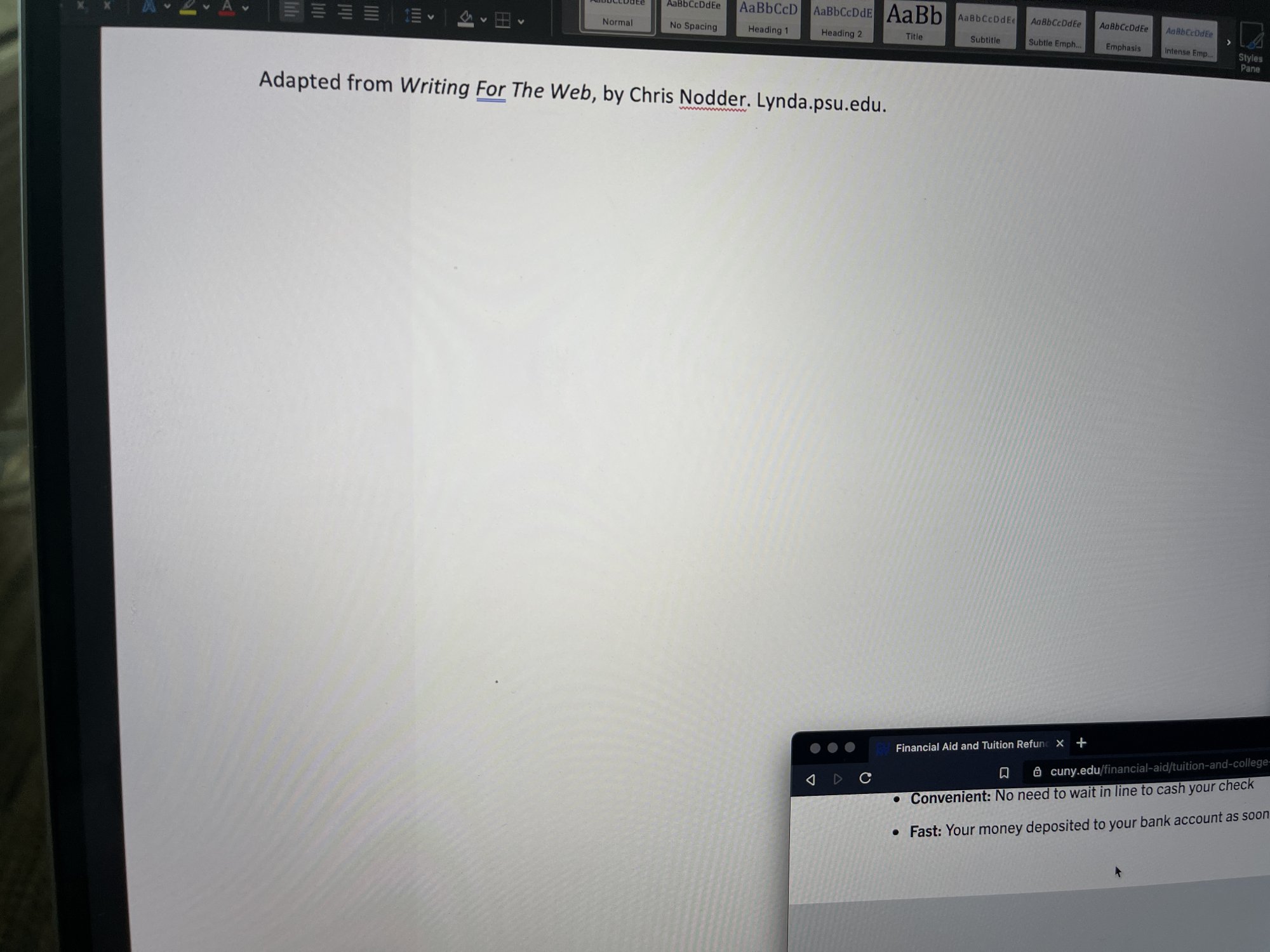

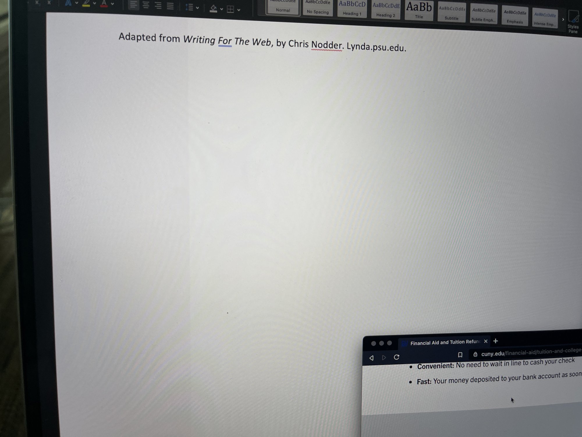

Just want to chime in to say I have the exact same issue. Light Grey overlay on the left side of screen.
If I reset the NVRAM on startup then it goes away for sometime usually but will always come back. What is this thing? On a 2019 16inch
