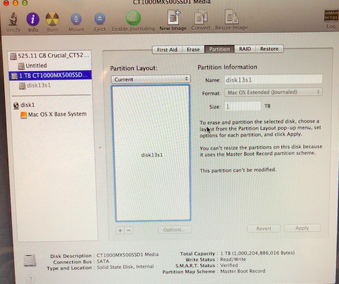

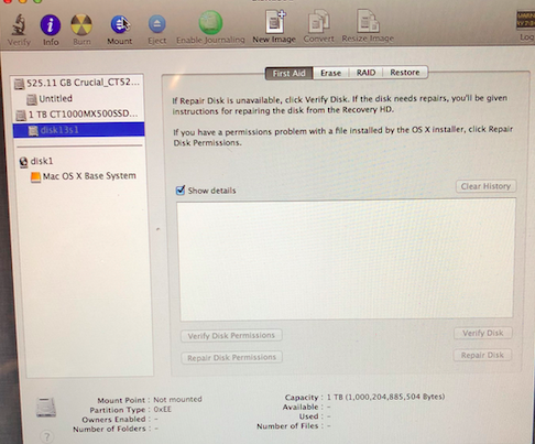

I have a mid 12 13" pro, which I upgraded to 16 gb of ram and 2 500gb Hard drives. Recently I replaced one of 500gb drives with a 1TB drive and now it appears it may have crashed. I am hopeful someone may have some better news. When I boot in disk recovery to check the drive, here is what I see.

When you select the partition, do you get an error message when you press "Mount" at the top?

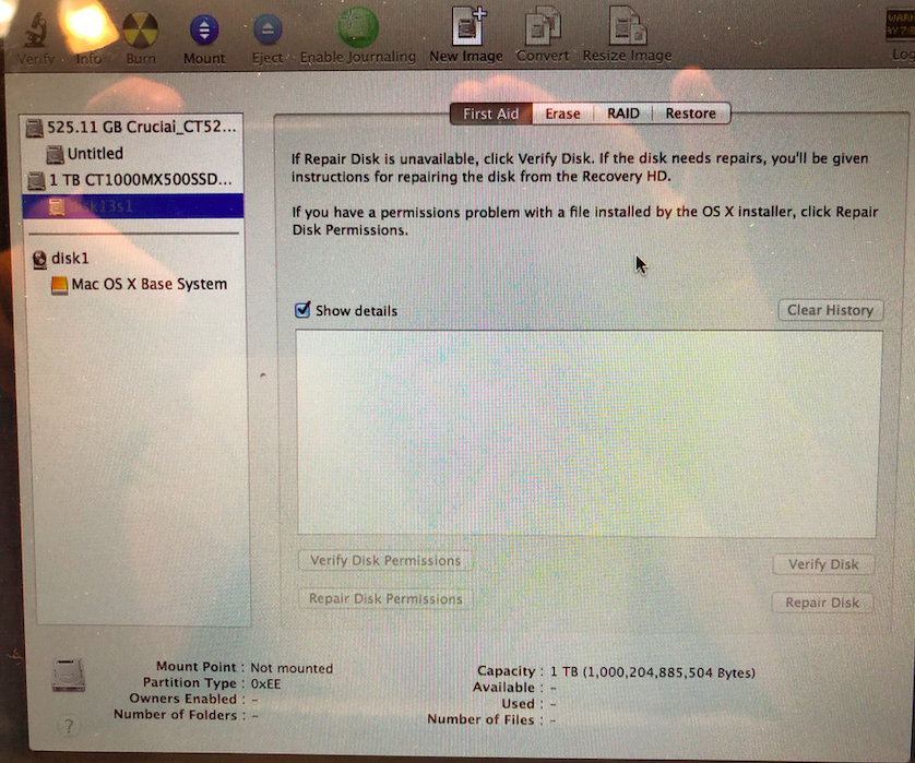

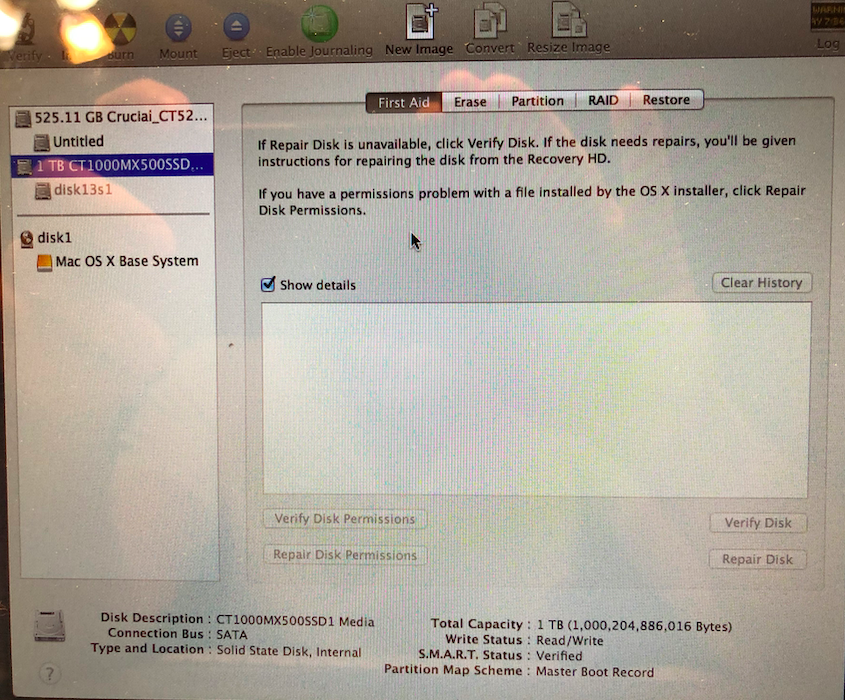

When I select partition in the top image, I don't get an option to select mount. When I select the disk13s1 I get the option to mount, which does nothing.

What happens if you try to create a new partition layout ? (assuming you don't have any data in there that need to be saved).
I have not tried that in part because that is my primary hard drive with my Mac OS and files. I don't have a ton of info I am worried about losing, but some I'd really rather retrieve if its possible.
You could try and install Mac OS on an external disk (e.g. usb), and see if you can retrieve any data, then try to re-partition the disk. It might be a h/w failure but it might be just a partitioning table issue that can be resolved with re-partitioning and format.
In a bit of weird but good news, I took my TB drive out, checked it on using an external housing on my wife’s MacBook Air and the data is still there and functional! When I connected it to my computer as an external drive, in recovery mode, my computer showed it as an unmounted external drive.
When I took it out, I replaced it with the original 500gb drive and what do you know, in recovery, it shows unmounted also. So now my question is why my drives show as unmounted, and what do I need to do to resolve it?
maybe sata cable is defective
You guys are on the money. THANK YOU! Cable ordered. I swapped my TB and 500gb drives around (the one I have housed in the disk drive bay) and BAM! I am typing this on my previously down computer. Thanks again.
