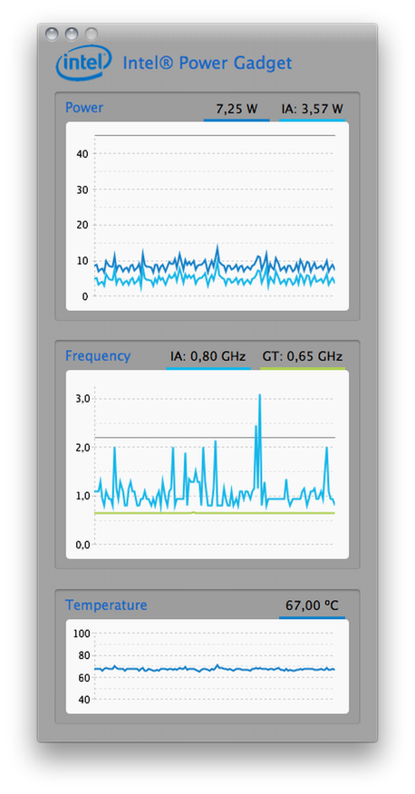

powerg_chrome_temp-png.569642
This is Chrome v43.0.2357.134 (and a few other apps on OS X 10.6.8). OS X 10.9.x and newer is even more energy efficient. The machine is the Early-2011 17" Sandy Bridge 2.2 GHz Quad-Core i7 with 16 GB RAM. > 30 tabs, hardware acceleration: on.
The machine (cleaned and 2 new fans) is nearly inaudible. The temperature is normal, IMHO.

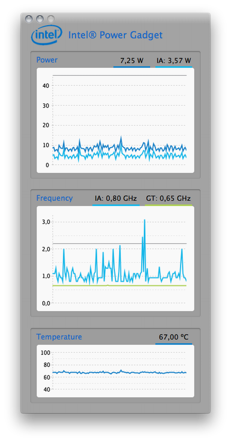

As others have said, 80C is well within the normal range. 80C would be considered on the hot side for light to medium workloads, while it would be considered on the cool side for heavy workloads such as gaming or intensive photo editing.
Mr. Retrofire posted a screenshot of Intel’s Power Gadget, which is an application that will show you if temperatures have become problematic in that they are causing your CPU to throttle/reduce performance. It can be downloaded from Intel for free: https://software.intel.com/en-us/articles/intel-power-gadget-20

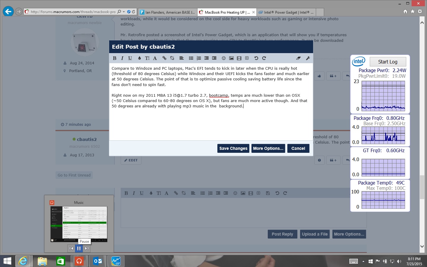

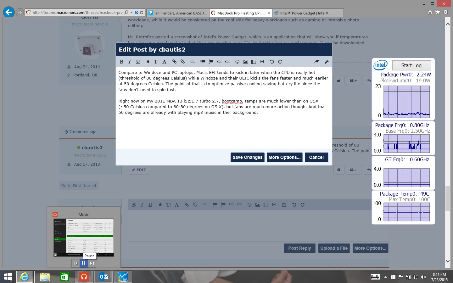

Compare to Windoze and PC laptops, Mac's EFI tends to kick in later when the CPU is really hot (threshold of 80 degrees Celsius) while Windoze and their UEFI kicks the fans faster and much earlier at 50 degrees Celsius. The point of that is to optimize passive cooling saving battery life since the fans don't need to spin fast.
Right now on my 2011 MBA 13 i5-2557M @1.7 GHz, bootcamp, temps are much lower than on OSX (~50 Celsius compared to 60-80 degrees on OS X), but fans are much more active though. And that 50 degrees are already with playing mp3 music in the background.
