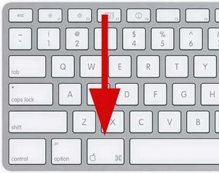

dont mind me asking since im kind new to mac whats cmd
Command Key
Also, if you want to reinstall everything, it's up to you it's your time.... BUT FIRST TRY RESETTING SMC AND PRAM...
