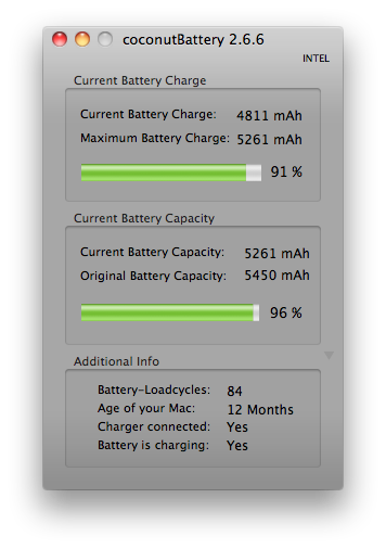

Ok. Would you post a screenshot of what this program (Coconut Battery) says? (Use Command+Shift+4+Space, then click the window)

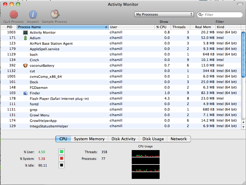

That definitely doesn't sound right. My last revision 13" Macbook Pro gets regularly 4.5 hours of use with Safari and iTunes running. Also, check to make sure that your backlight isn't all the way up, Bluetooth is not on when not necessary, and open up Activity Monitor (in Utilities) and see if anything hogging processor usage. (Post a screenshot of that too please)

Here is a screenshot of my CoconutBattery reading for some reference.

txhockey9404 - I have attached the 2 screenshots here, have a look. The macbook pro charger is messing around tonight even more, I think that the pins on either the battery or the charger are damaged.

call Apple customer service or take this back to Apple. There is no reason that a 6 week old mac should be at 8% battery health so there is something wrong with your battery. Hell i know people with 6 year old macs that have more than 8% health.

That's the current battery charge. Not the most it can hold. coconutBattery looks fine to me.
Based on your activity monitor, flash is running in Safari, which turns on the nvidia discrete graphics. That kills your battery life. You might want to download gfxcardstatus and watch your graphics. Stay with the integrated intel graphics, and you should see normal, 6-7 hours with light web browsing at 50% screen brightness.

I would second that. I must have seen about 15 people with a paperclip stuck in the magsafe port, complaining that the charger wasn't fitting properly. Your battery looks fine, except I would be kind of concerned if it had 20 cycles in 6 weeks. Do you use the battery a lot or just have the Macbook on the charger? If you just use it on a desk with the charger plugged in, that could indicate that the charger is not working properly.
Repost after doing a calibration, then you will get a more accurate reading
You sure? I generally use Firefox, and have never seen this, so wondered whether this was a Safari thing. But I've tried it, and even with the Safari flash player plug-in running my system sticks firmly to intel graphics (and my system is auto-switching, 'cos if I fire up X11 it switches immediately).
