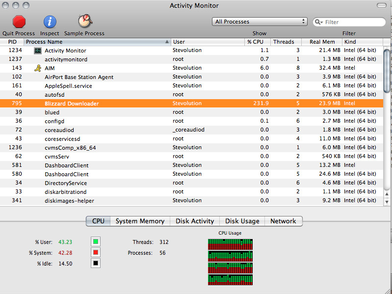

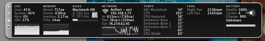

So I got my macbook pro yesterday and i've been doing some basic stuff on it. While I was installing World of Warcraft, the computer jumped up about 101 degrees celcius. I know I shouldn't trust istat pro 100% but still, my fans are running super loud and the computer is very hot to touch. I'm not running any heavy programs or doing any gaming. I had Aol Instant Messenger on, and WoW instaling in the background. I'd like to also add that when opening various programs I get the spinning beachball very often. I don't want to be over reacting but I just got it but it's bothering me a bit. Should I take it to a genius? Thanks in advance for your input guys!
Have a look at Activity Monitor ( Applications / Utilities / ) and select All Processes and sort by CPU to see what the culprit may be.
image below uses sorting by CPU as an example

Observe how your Mac behaves, I would recommend to enable process viewing in istat, so you may see if actually some process is taking 200% of your CPU and hence the temperature.
My other advice is, that if you plan to play some game or use a heavy app, set your fans to spin to max RPM before you start doing the task - this way you will not let the cpu to reach critical temperatures.

Looks like the culprit was World of Warcraft installation client. I don't get why the computer would have to use 200% of the cpu to install the game .. 😕 If anything, I'm downloading this from blizzard's website so it's not from a disk but from online. Is that usually the case if the internet is involved? my internet is super slow during this process too. There was another one called "Kernal_Task" that was taking about 55% of the cpu. I don't know what's going on. Even when opening Photoshop CS4, I get the spinning beach ball for a good 2-3 seconds before it finishes loading. Should I make an appoint with a apple genius?

I don't know about the Blizzard Downloader, but Kernel_Task is a system process, that sometimes gets taxed, Blizzard Downloader has surely its hands in it. If you finished the installation, I'm sure the CPU will go back to normal.
And the internet speed is compromised due to the Blizzard Downloader doing what it does, downloading. Once the download is finished, the internet will be at full speed again.

Your MacBook Pro i7 would be running extremely hot if you were taxing the processor as much as your activity monitor CPU graph shows.
