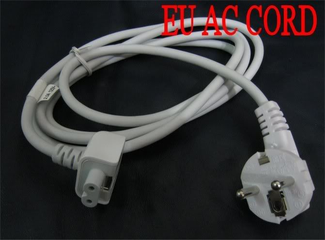

I am in Europe at the moment and I bought the Apple international adapter pack or whatever it's called. I am currently using the little EU plug (first picture) and as you can see it only has two pongs and no ground.
When you buy a macbook here in europe they give you that and also the cable (shown in the second picture). As you can see the plug at the end of the cable is bigger and has connectors for the ground.
Do you think using the cable will fix my problem?
Do you think that this is a problem that all macbook pros have or is it a problem only some machines have? Because if all machines have it, why would they even give you that little two pong plug that causes it?

I'm Swiss using a Macbook Pro Unibody with a Swiss type power adapter that has a plug with 3 prongs and never felt any electricity in the case.
On the Swiss type power adapter, the plug part, the one which is replaceable (for use in different countries) actually has a cord attached to it with a 3 prongs plug. On the power adapter, the circular thing that holds the plug part is metallic and is connected to the earth prong of the plug, so it means that the power adapter is properly connected to the ground.
It seems that the US Magsafe adapters have only a 2 prong plug directly attached to the adapter, in this case the power adapter is not grounded, which means that if the electrical installation you are connecting to has a bad ground then you can have a potential difference between your notebook case and earths ground, resulting in tingling etc...

It has to do with the short power adapter people use in europe! As soon as you use the long power adapter (also called schuko in germany) you won't have have the problem. I cannot really explain it, but that is the problem.
Ah, well some people said that didn't make a difference. Which would mean their outlet is most likely not grounded properly.
