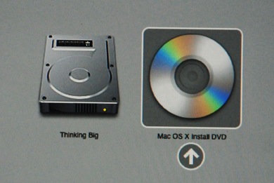

I Have had both the screen below while trying to use the CD. So is it not working? Don't have another Mac If I could get a working mac anad stripped out its HDD and put in mine and then tried to install the OS on that one would it cause any issue then putting the drive back in mine.

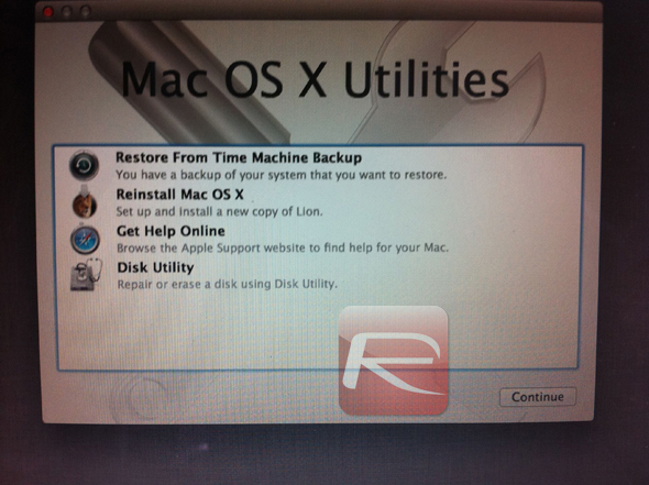

Maybe the disc is recognized but certain files are corrupted or there are bad disc sectors (although unlikely). How did you boot into the Mac OS X Lion recovery utility?
These are screen shots from the net because I did not capture them at the time, but they looked the same, except I have a Snow Leopard CD
Oh okay. If you pulled the drive out of a working Mac, putting it back in won't do anything bad, assuming you don't break the hard drive yourself. You could try using that in order to check if the CD mounts on the computer, but keep in mind that the system needs to be running 10.6 or later in order for it to boot of your computer (maybe 10.5 as well, but I'm not sure).
