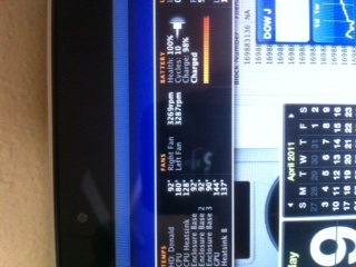

Thanks for the response, that is the thing, I am not doing anything on the computer when it happens other than surfing the internet. I do not have any additional programs opened other than safari. I could see if it was being used for Gaming. But, just every day stuff? I do not remember the fans running constantly and I feel the heat coming through the keyboard. Any other Macbook pro users have similar issues? I really do not want to send it back if they are not going to do anything with it.
Here is a snap shot of the reading using istat

Fans will always be on, but should be at 2000rpm when nothing is happening.
Don't use your crazy farenheight scale, but in civilised speak somewhere in the 50-60oC range is good when nothing much is happening. Under load 80oC is fine, it will shut itself down before becoming dangerously hot.

78C, the temp you reported in Fahrenheit, is fine for the 2011 MBP. Especially if the fans are running at 3500RPM. And especially if the computer is running under load.
Under light/moderate use, the temps shouldn't get above 50~65C.
Number crunching apps - 80C is the upper limit for my taste, and most laptops under heavy load don't get above 80C. The i7 does run hot, but the documented reports of poorly-applied thermal paste are sufficient evidence: http://www.ifixit.com/Teardown/MacBook-Pro-15-Inch-Unibody-Early-2011-Teardown/4990/2
When idle, my MBP hovers at 40C. That's fantastic. Under light use, it gets between 48~52C. When I have Parallels running XP, 48~61C is reported. (that's the CPU temp, not the temp of any individual core, which would be slightly (~8C) higher...)
Playing UT2004 in Parallels, the MBP gets to 76C. Fair. Add in Prime95 to stress the system WHILE playing, to simulate full load and multitasking between game and background render, the temp jumps up to 93C. That's too high; I can recreate the same conditions on my little token PC notebook with an i7 quad processor and temps remain at 76C.
To me, anything over 80C is a cause for concern, with being over 90C a massive cause of concern. (the CPU is said to run up to 100C, but that's beside the point. There's a reason companies have special rooms, temperature controlled, for their servers - or why any computer has fans and other cooling mechanisms. Heat damages over time. The more the heat and the more the constant level of it, the sooner the electronics fail. Nobody is immune from the laws of physics, which is genuinely unfortunate...)

I re-read your OP. It doesn't really say if you're running apps, or if it's sitting there idle. My own 17" MBP, running idle, in a 22C environment, runs at an awesome 35C. Under load, or as much as I can right now, it gets up to 88~89C. If it's getting up to 175F ( 80C) while idle (or even under light usage (e.g. file copy, web browsing with a couple of open windows)), then there's a big problem.
