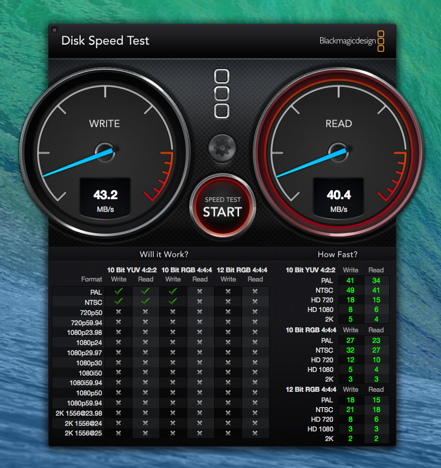

This was my result with Blackmagic 43.2MB/s Write, 40.4MB/s Read with 5GB stress.

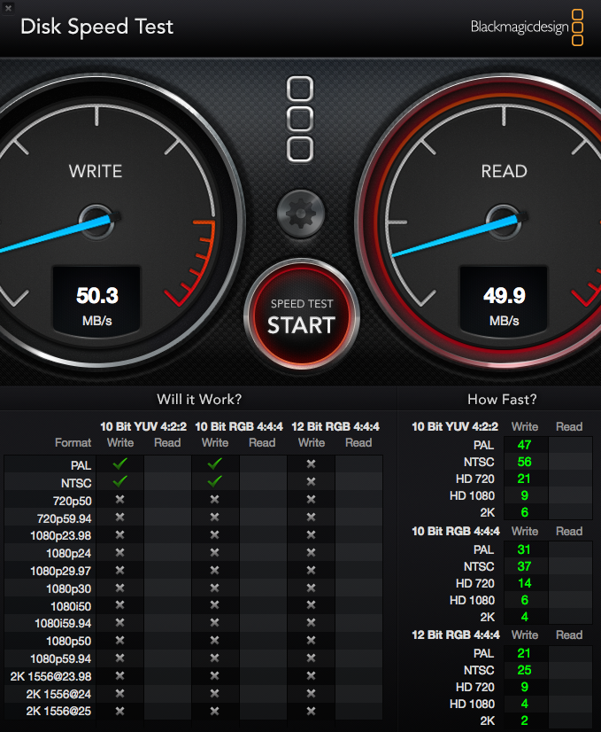

Then 50.3MB/s Write, 49.9MB/s Read with 1GB stress.

Pretty bad but I think it's normal in hard disks. With a SATA III SSD (is your MBP SATAIII-capable?) you'll get values around 350-400MB/s or even better in some cases.

It's quite slow.
Buy an SSD and watch the speeds shoot to beyond 450MB/s. SATA3's maximum speed is around 520MB/s.
On Haswell Macs with PCIe SSDs, it will go all the way to 750MB/s.
New that drive should be closer to 90 MB/s. But with a few years of age and a somewhat full HDD I'm not surprised that the rates are down.
New MBPs with fast PCIe SSDs take about 8-10 seconds to boot. With a 10x slower HDD it is not such a big surprise that the boot process takes so long.
