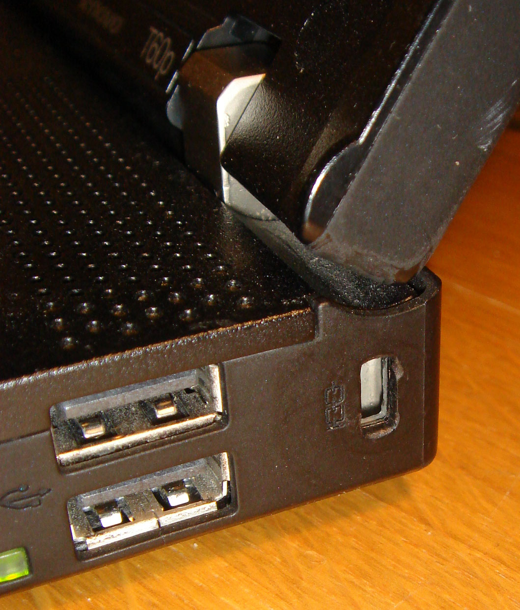

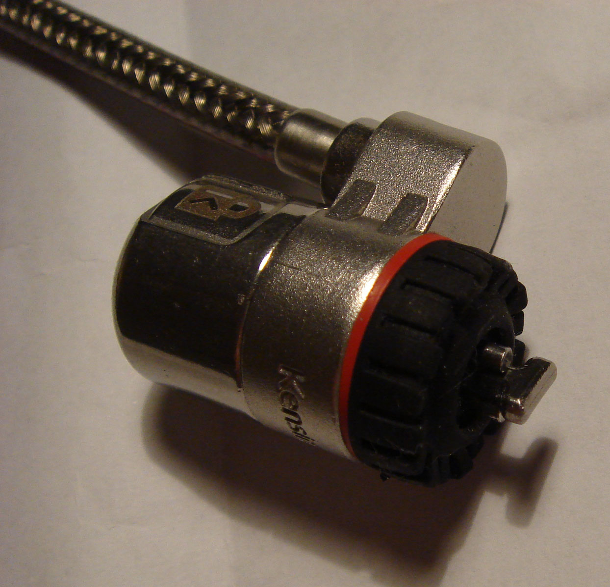

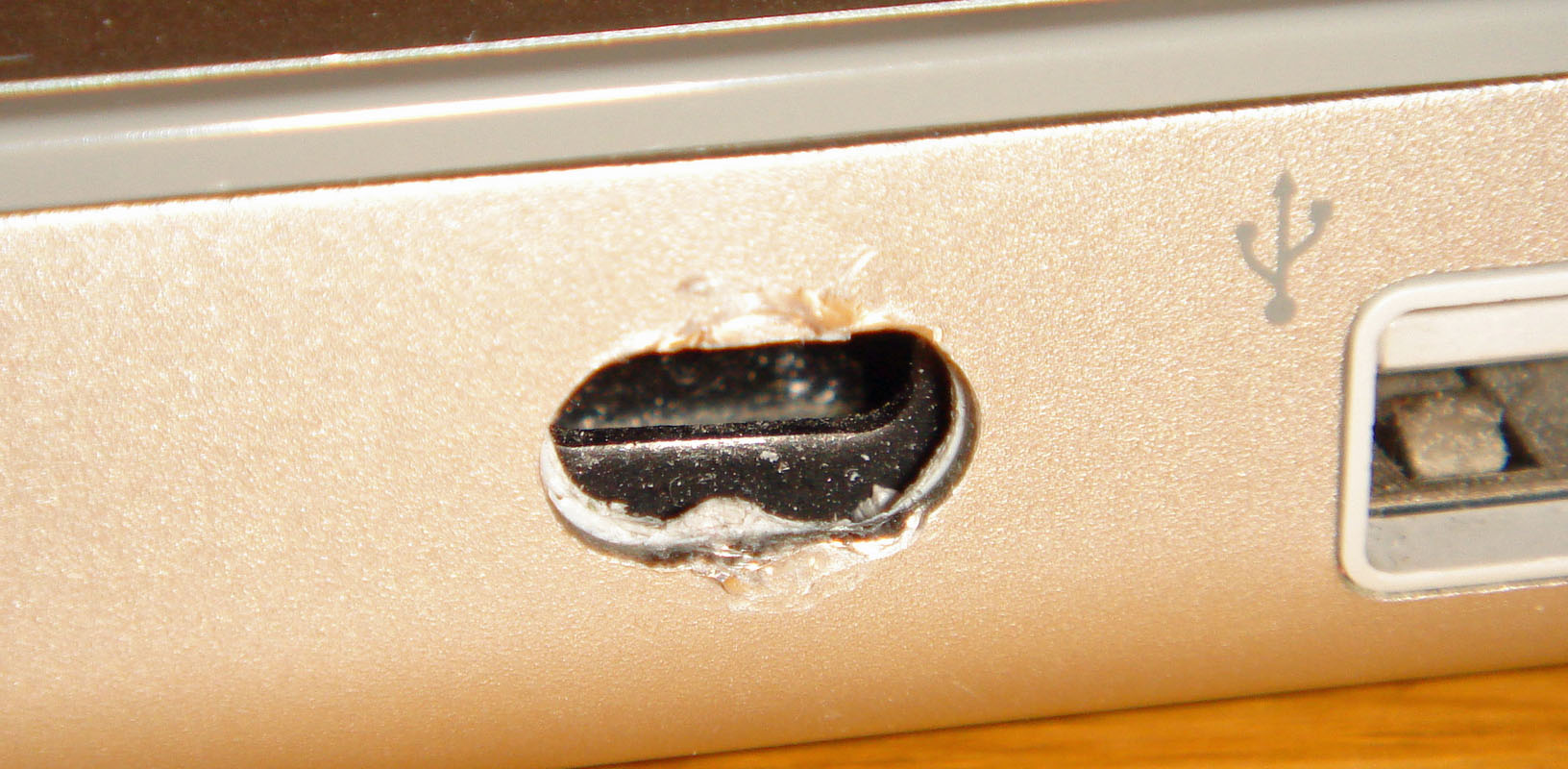

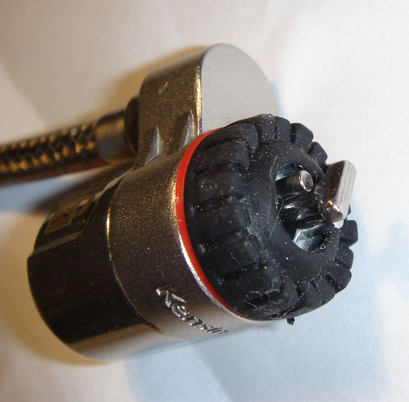

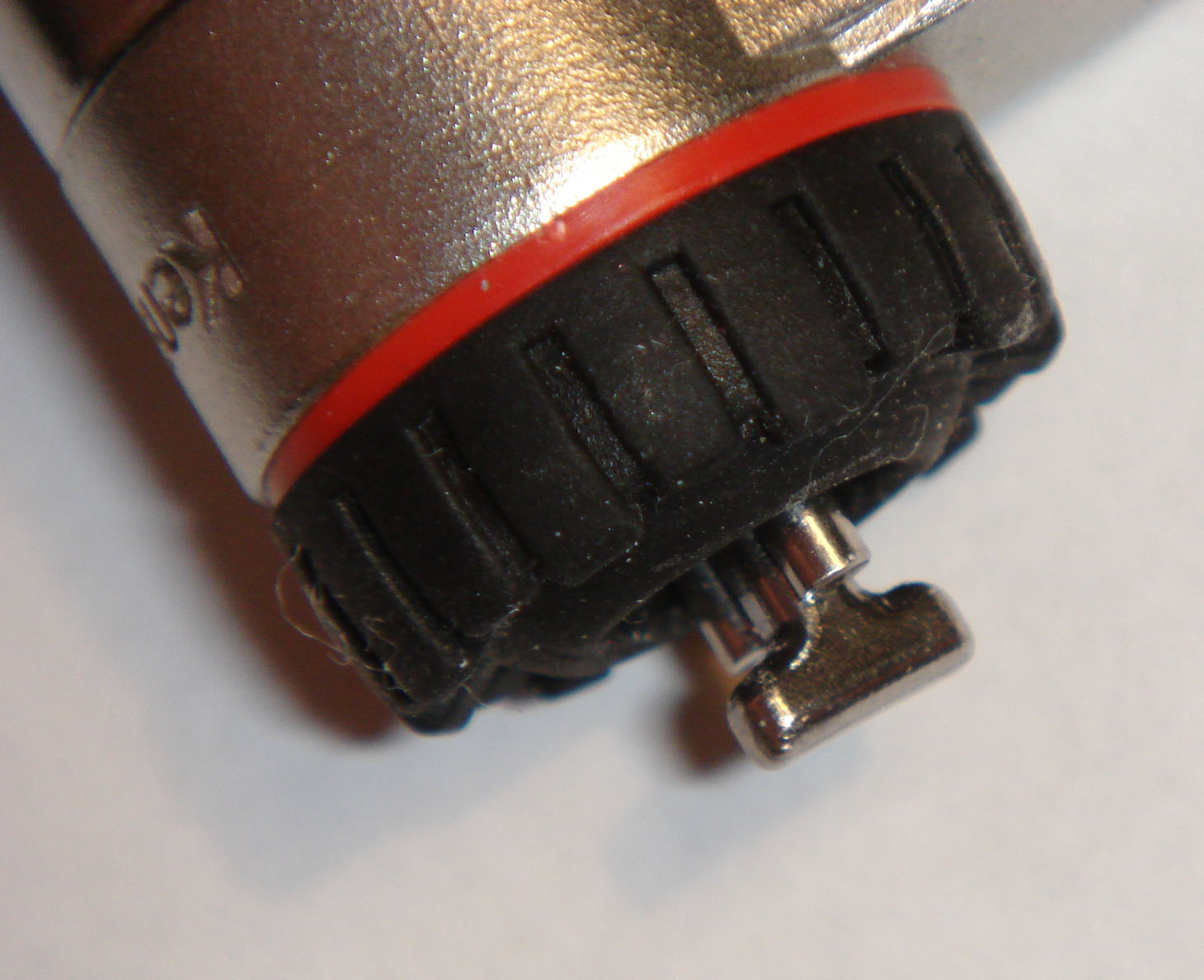

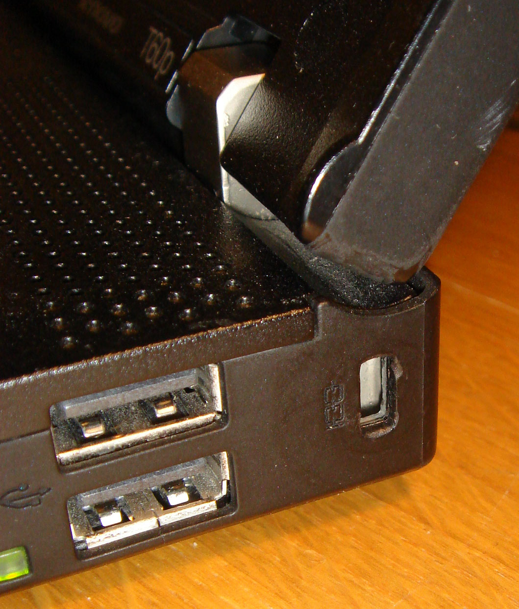

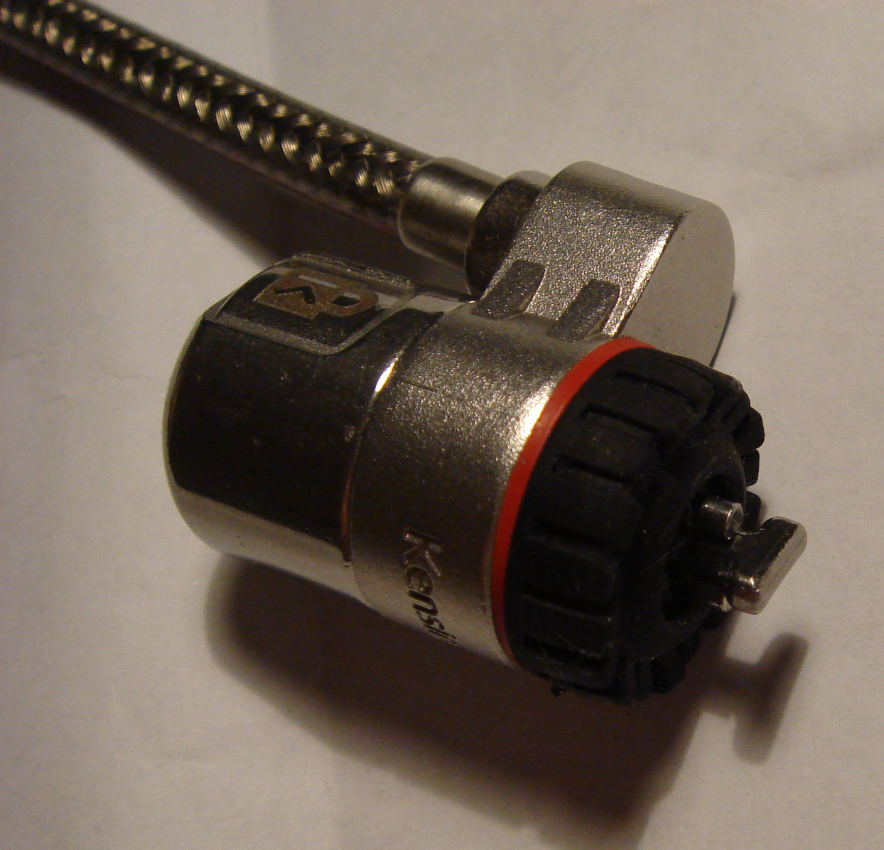

I have uploaded 5 pictures: 1 of the MacBook Pro slot; 3 of the Kensington Microsaver DS cable lock in the "locked" position; 1 of a security slot from my Lenovo Thinkpad T60p. (Cropped, reduced, etc. thanks to Photoshop Elements 6.0...)
Referring to the MacBook Pro slot pic, you can see the black locking plate "floating" around in the back.
OUCH... That looks nasty! 😱😱😱😱😡😡
I'm sorry your going through this..
There shouldn't be anything giggling inside your MBP, so if it's the metal thing from the security whole that's floating around in there, I would imagine Apple won't mind to replace the unit, cause it's a faulty/defective unit...
Wish you all the best! 😉

It is very clear from your photos that the design of your lock is at fault and is clearly not suitable for the MBP.
Under the locking T-bar are two prongs, which are in contact with the aluminium side of your MBP. Any slight movement will create friction with the result that your lock is slowly sawing into your MBP. Most locks have a T-bar going into the slot with rubber grommets in contact with the sides to prevent such external damage.
You should look for a lock that on opening retracts the T-bar into an I-bar, rather than one that rotates the T-bar to lock. Trust makes such a lock and is usually much cheaper than Kensington to boot.

i would have to agree. my targus doesnt have those two prongs. Its a flat surface below the "T" looking lock.

I don't use any type of lock for my computers but I thought the prongs were unusual too. I've never seen such a lock.

well indeed, it's either Apple's fault or Kensington's, since either the lock-hole/plate is not properly manufactured (shouldn't be bendable like that)
or the lock Kensington sells (and Apple for that matter) is not suitable. I called Kensington and they offered to send me a new lock.
Now I told them that the problem might be that due to the rubber protection ring, the T does not get deep enough and in this case made it between the allunimium casing and the steel plate, bending the steel plate to the inside.
What do you know, the newer model locks don't have that ring anymore...
