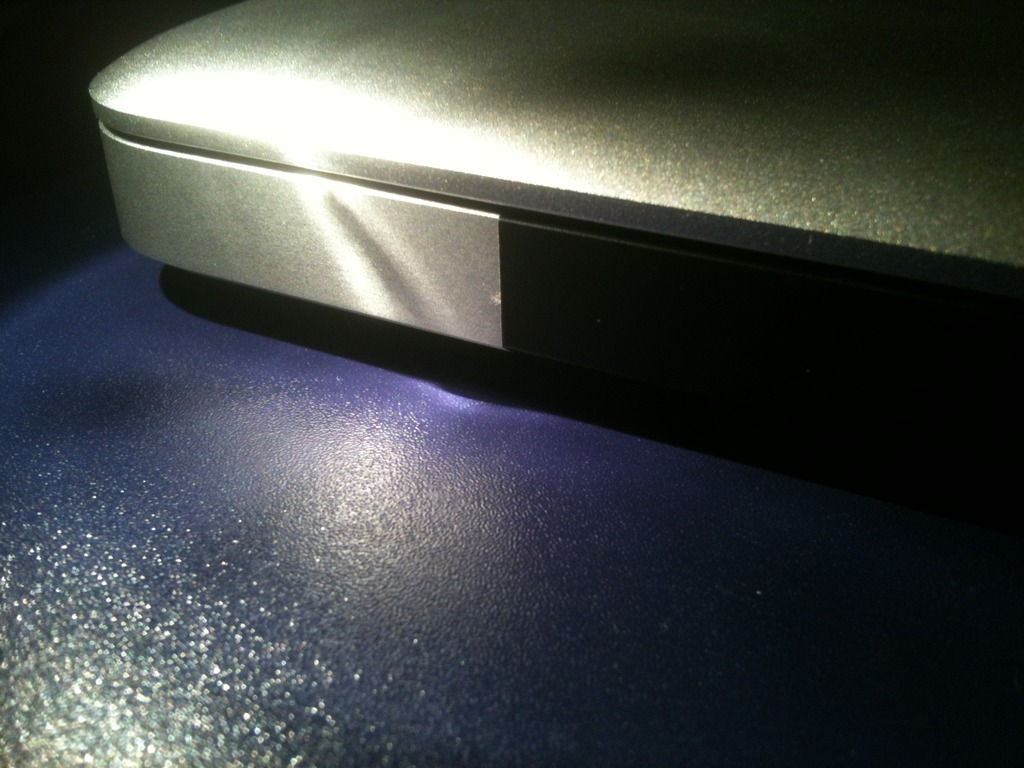

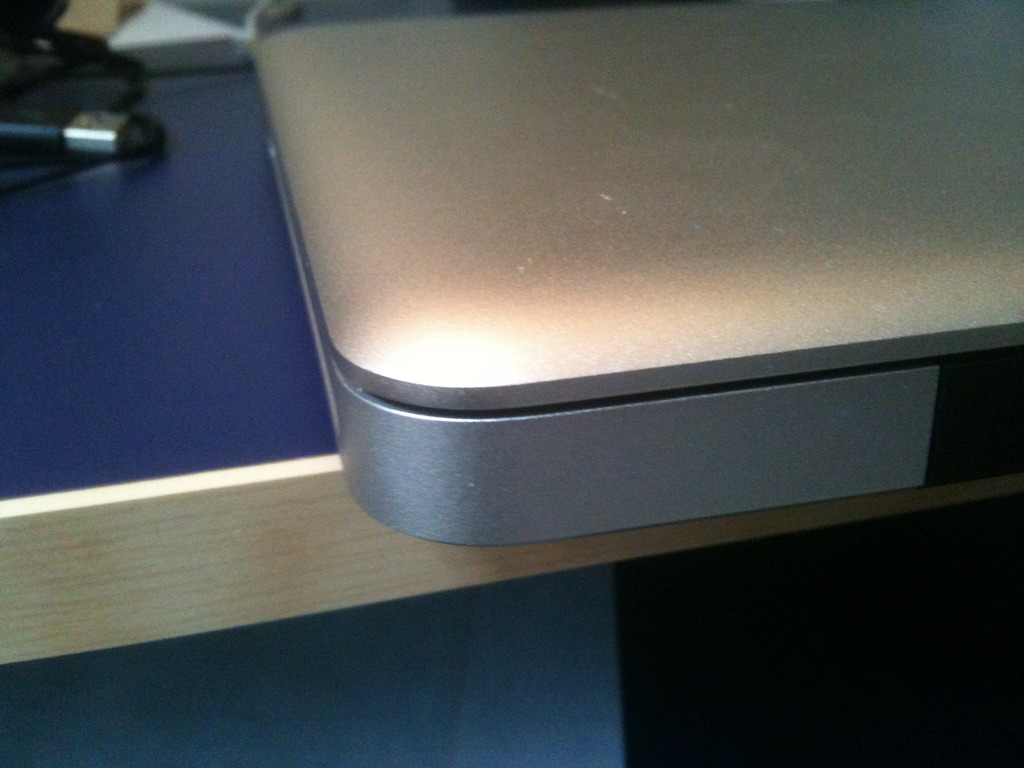

I may have prematurely called the unibody of my mauled MacBook 'undamaged.' It appears the position of the corner and hinge shifted slightly so the (bent back) back cover slightly rubs against the corner when closing. The hinge has a slight gap on the bad side as well.

Is it the hinge mechanism or unibody itself?

Yep, thats what I was seeing. Compare the black hinge strip end to end, is it the same with respect to the screen end-to-end? Is the gap between the top screen cover and the unibody the same on both sides?
The gap between the unibody and display is smaller on the bad side. There is a gap between the end of the black hinge strip and the unibody, unlike the good side. The hinge strip is (somewhat) flush with the display.
If it's the body, I suppose there's nothing to be done.
