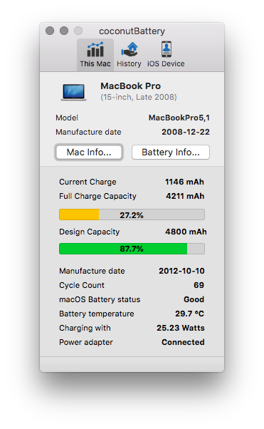

Oddly the battery lasts quite a while - it'll run for a couple hours still, and it's in fantastic health. I just pulled it out and measured it, and it's flat as a board. I'm gonna keep noodling with it, but I think I can rule out the battery for the time being.
What a beast... I'd expect it to have like 60% battery capacity right now.
The battery stats do look very well indeed. I am wondering if you actually put the battery under the load like running Unigine Heaven with full brightness on? You can let it run until the battery is completely depleted and the Mac turns off. This will be a calibration of sorts, and upon completion the battery health can either go up or down.

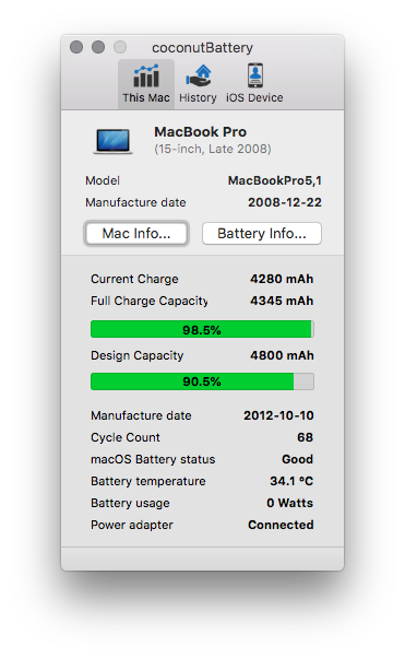

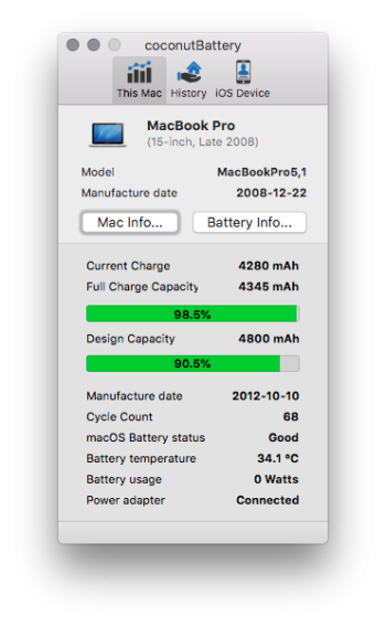

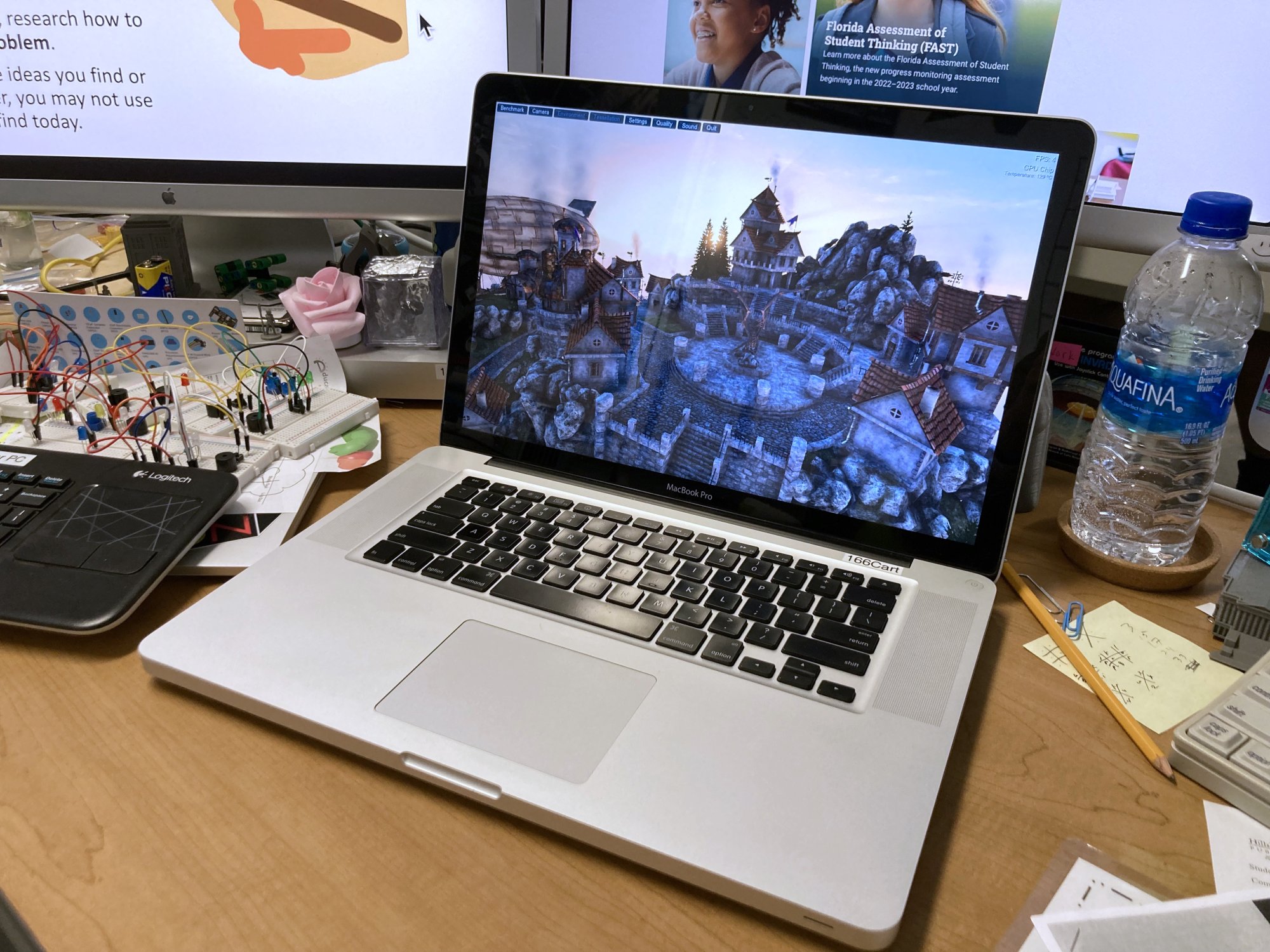

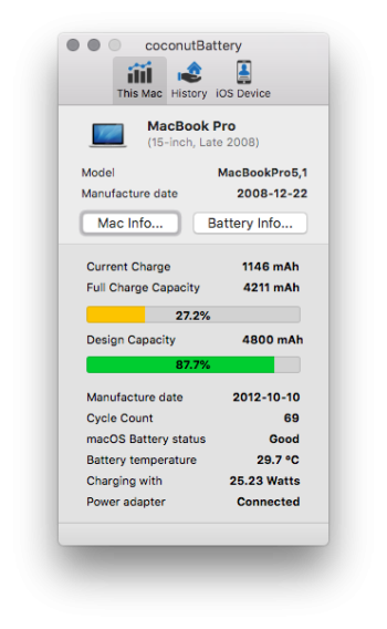

I took your advice and decided to run Unigine Heaven on it. Screen brightness on highest and on battery power, it chugged through it at all of 3-4 FPS for a bit over an hour and a half before it finally pooped out. None too shabby a showing for this old beast!
FWIW I do have it fixed on the 9400M and never touching the 9600M GT. Not sure why the GPU shows at 129C, I can assure you that's not accurate given that it started there and never changed. Even so, that's not a terrible showing for an 11-year-old battery in a 15-year-old laptop 🙂
After the full drain "calibration" it's showing at 87.7% health 🙂
