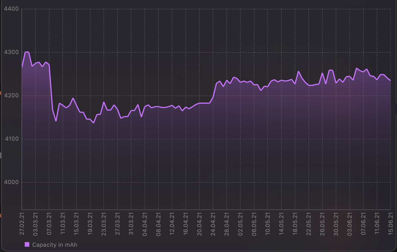

Here is what my ioreg value has done since Feb. Machine was new in Nov but I didn't start recording until end of Feb. Started at 98.1%. Dropped to 94.5%, recovered to 97.3%. Currently at 96.6% after 36 cycles.
Note that in early March my machine was less than four months old with about 20 cycles and at 94.5%....worse than yours. OTOH my Apple Battery Health pref pane number is still 100%.
I have used AlDente since mid Feb, since I never saw Apple Battery optimisation work on my MBA in the first two months.

Another month and now 40 cycles and the battery recovery continues! I have been using AlDente since mid Feb but make no claim on its behalf. Main point is that my graph confirms that looking at an individual battery health number from ioreg reported by the third party utilities is probably misleading.
