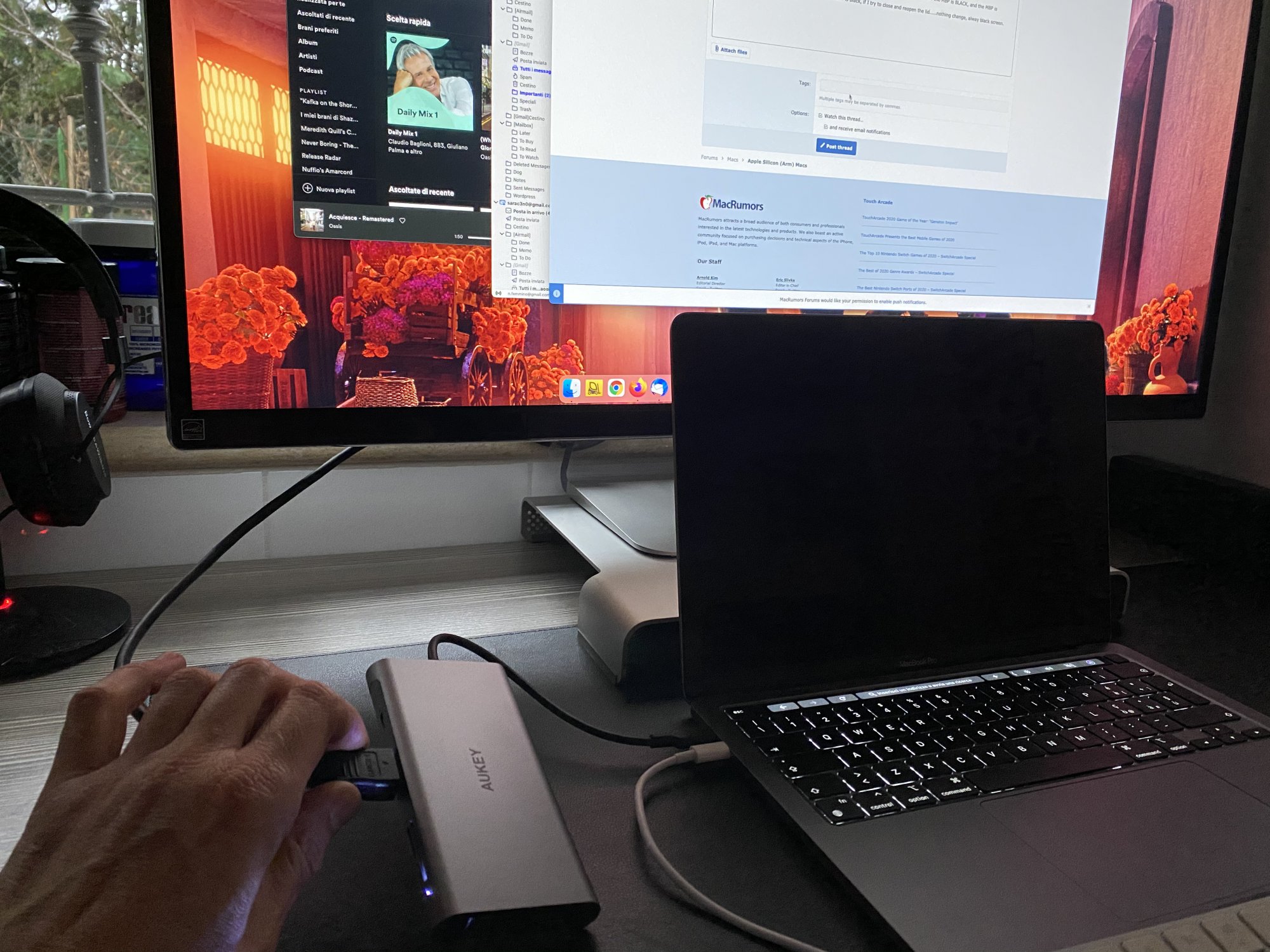

I plug my MBP M1 into my monitor with an hub, the monitor is ok, everything else works, screen on the MBP is BLACK, and the MBP is charging.
If I unplug the MBP M1 I can't use it because the screen is black, if I try to close and reopen the lid.....nothing change, alway black screen.

Turn off the M1 and unplug the hub and the M1 from the monitor. Leave it off for 1 - 2 minutes and turn back on. See if that fixes the problem.
I have read reports of some hubs causing this kind of problem, as well as rendering the M1 dead (can't turn on).
nope, unfortunately your solution doesn't work :-(
You should contact Apple support through the Apple Support app and see what they advise you do. It sounds like you may need to send it back and get a new one if you are still in the return window, or have them take a look at it to correct whatever problem is keeping the screen from coming on.
I just contact AS and I have an appointment on thursday. How many days is the return windows?
I don't think HDMI plays nicely with the M1 chip. Try doing direct USB-C to USB-C from the monitor if you can. If not, I suggest getting a monitor with a USB C port so you can just directly plug in.
But is not the monitor not working....is the screen! If i open the lid.....I can't see anything :-(
Will mirroring the display work at all? seems like a setting just using external display like clamshell mode. If not could be a software or hardware glitch
My MBP M1 also faced similar problem. At that time, I was browsing through Safari when the black screen happened. I didn't even plug anything to the macbook...
