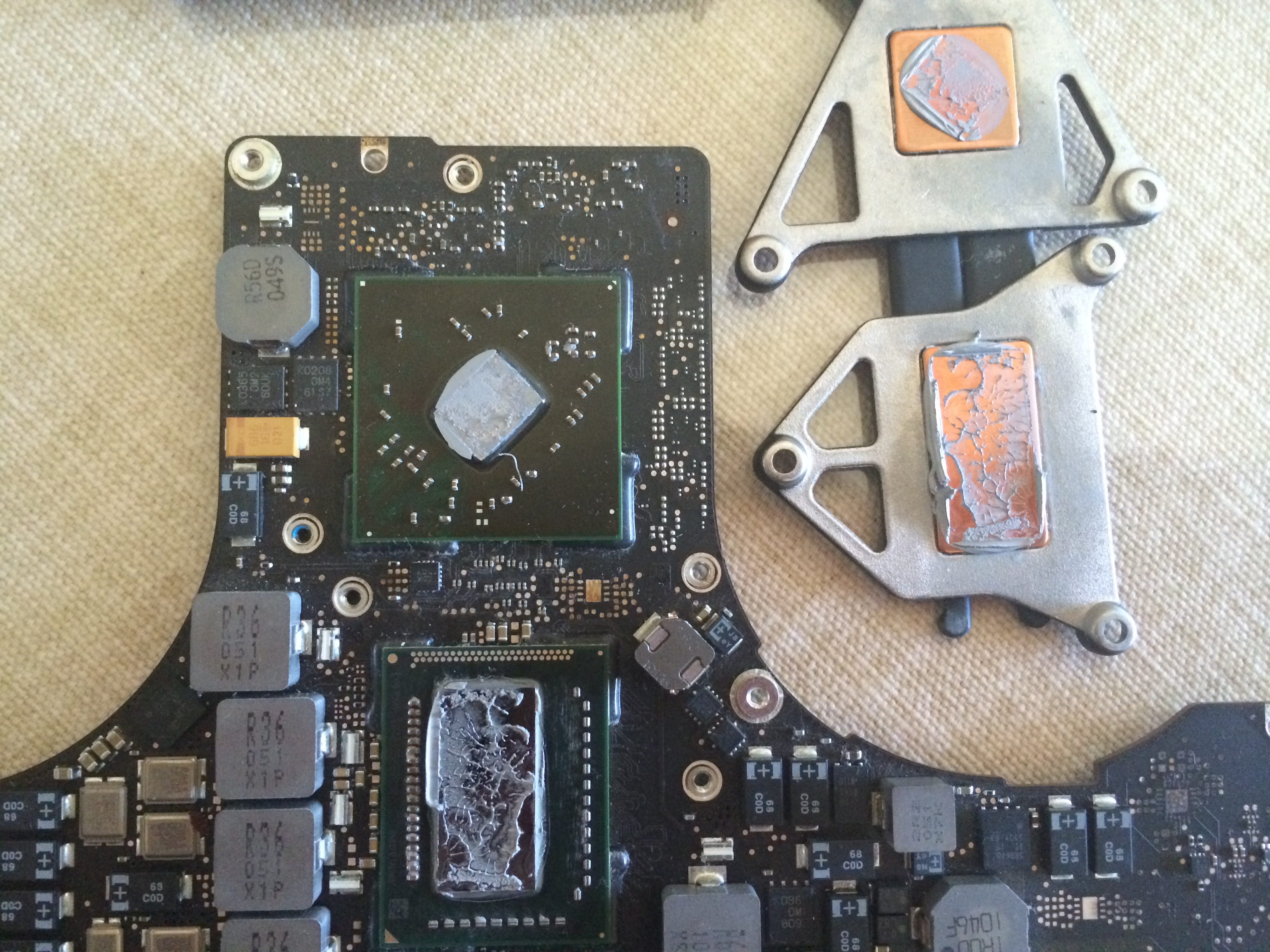

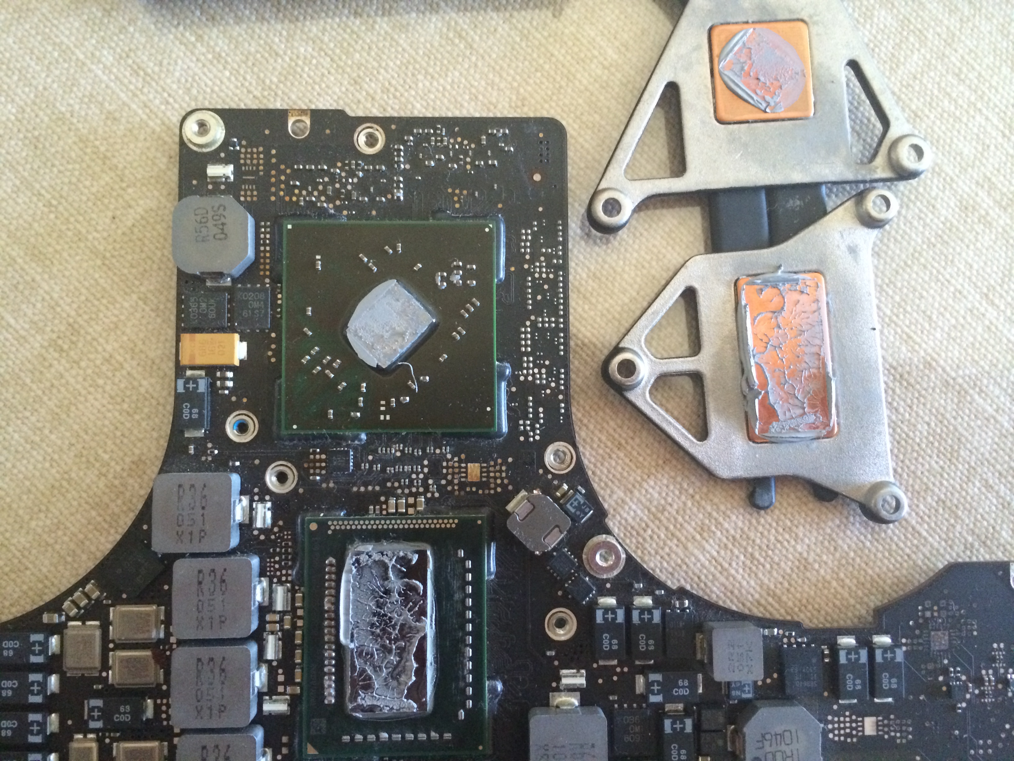

Do either of you know if opening my macbook pro voids the three month warranty that I received for replacing the logic board?
Went ahead and took it apart. This is what I found. Not as much thermal paste as in other logic boards that I've seen but still seems like a bit too much for a GPU chip of its size.
😱Oh Boy! I'd never have the courage to take it apart!😱
