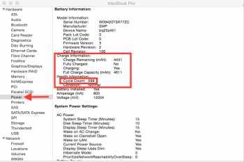

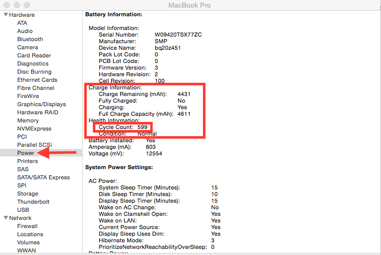

BTW, about the battery, have you checked System Report to see how many charge/discharge cycles it has been through, and the remaining charge (measured in mAh - milli ampere hours, I guess) ? Our mid-2009 MBPs have a battery cycle life of 1000 charge/discharge cycles.
:apple: > About this Mac > System Report > Hardware > Power > Battery Information > Charge Information (and) Health Information
See attached image. I have a mid-2009 MBP too and my battery is normal at present.
Checking this will allow you to at least eliminate the battery as a potential problem if everything looks normal there.
